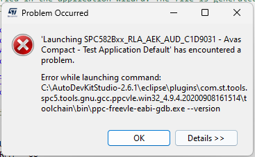

I installed newer version of AutoDevKit studio from ST website and imported a project fromm samples.
I tried to flash the generated elf but it is giving following error.

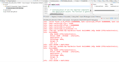

I just imported the same demo you mentioned in the post using AutoDevKit 2.6.1.
I cleaned and compiled the project. At this point, I flashed the generated Elf file into the board using OpenOCD without any problems. (see image below)
I suggest removing the project from the Project Explorer, re-importing it from scratch, cleaning and recompiling it, and then flashing the compiled code using OpenOCD.

It looks like plugins are not installed properly.
I checked and found that ppc-freevle-eabi-gdb.exe plugin is not available in repo. I also reinstalled IDE but not success.
in older version I could see 879 plugin folders inside eclipse/plugin path where as in new installation on diff machine having 764 plugins
can you provide me necessary plugins and installtion steps?
