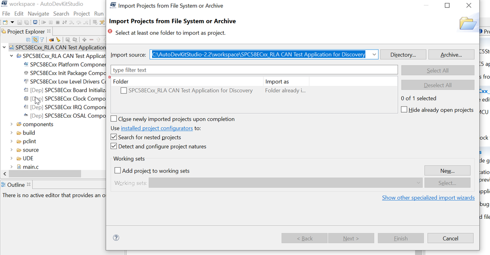

But most disturbing: I miss my examples from the application library! If I choose AEK-MCU-C2MLIT1 or SPC58EC I cant see any CAN example. Even if i filter for CAN I get some results of which some dont even contain any CAN.
The RLA CAN Test Application for discovery is gone (I used it on 2.1), I can find it when I select SPC58x Gxx - which does not work (UDE can´t get contact and load this onto the board)

‎2023-11-19 7:57 AM
Attached you can find the CAN RLA example to be imported.
Unzip it and put it in a working folder or AutoDevKit workspace folder.
Go to File>Open projects from File System
Generate and compile the code.
I have also attached a PDF document with basic explanation on CAN usage.
