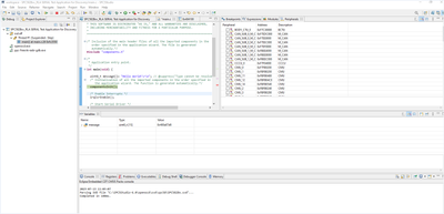

I just moved from stm32 with Cube IDE into AutoDevKit with an AEK-MCU-C4MLIT1 discovery board.
I am so frustrated after a complete 8 hour spin and still no results.
Why is AutoDevKit called an IDE when the Debugger is still external? I dont get it.
I tried to get it running and found posts heer, 3 years old already stating that the eclipse integration tool does not work anymore.
I run into trouble with the external UDE debugger as well, plenty of them.
Is there an IDE as CUBE where I can get everything for the SPC controllers? Is there an explanation and code example of simple things like blinking LEDs, hello word kind of things? Or is there a way to run SPC58 in CubeIDE? Tips, suggestions?

Hello ,
You can not compiled SPC58 in CubeIDE ?
but you can install OpenOcd in AutodevKit Studio or SPC5Studio by using update site mecanism :
or
Install PLS Integrated debugger
http://spc5tools.spc5studio.com
Openocd (Linux/Windows) with eclipse plugins have a better integration in SPC5Studio/Autodevkit Studio than PLS (Windows only)

STM32 (arm) has a greater community than SPC5 Family (powerpc) (more automotive part) but not the same bandwidth.
Same company but different IDE.
the good advantage of SPC5Studio / Autodevkit Studio (based on eclipse framework) , it is possible to install your own debugger and integrate it in your IDE. (like Cube)
  • Openocd (cf screenshot)
  • PLS (partnership)
  • Trace32
  • Segger
  • and so on ..
I am here to help you :grinning_face:
