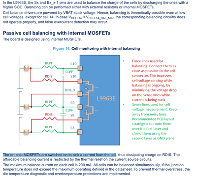

There are multiple functions related to cell balancing in AEK-POW_BMS63EN_id. However, when I tested, none of them work. Here is my main code based on the "SPC58EC - AEK_POW_BMS63EN_SOC_Estimation_14Cells_GUI application for discovery" example. Could anyone experts give me documents about how to manually use cell balancing of this board? and explain detail how cell balancing of AEK-POW-BMS63EN works?

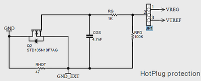

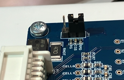

  2. Disconnect your AEK-POW- BMSHOLD connector
  3. Check if the Jumper JP1 of AEK-POW-BMESEN is inserted as in the picture below (pins 2-3)

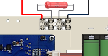

  2. Connect your sensing resistor as follows:

Dear ATROI,
Thank you so much. Back to the balancing of the new driver, I found out that only two value that can change the balancing status of the system (in the void AEK_POW_BMS63CHAIN_app_parserData(void)):
AEK_POW_BMS63CHAIN_app_dataChain[AEK_POW_BMS63CHAIN_chainidx].AEK_POW_BMS63CHAIN_nodeData[AEK_POW_BMS63CHAIN_devidx - 1].AEK_POW_BMS63CHAIN_Pack_Enable_Bal = 1;
AEK_POW_BMS63CHAIN_app_dataChain[AEK_POW_BMS63CHAIN_chainidx].AEK_POW_BMS63CHAIN_nodeData[AEK_POW_BMS63CHAIN_devidx - 1].AEK_POW_BMS63CHAIN_Pack_Enable_Discharge = 0;
When I changed the AEK_POW_BMS63CHAIN_Pack_Enable_Bal to 0, the balancing for each cell turned off to 0.
When I changed the AEK_POW_BMS63CHAIN_Pack_Enable_Discharge to 1, the balancing for each cell turned on to 1.
However, All the below function seems do not works in any situation or I do not know how and when to put it in the code.
