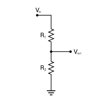

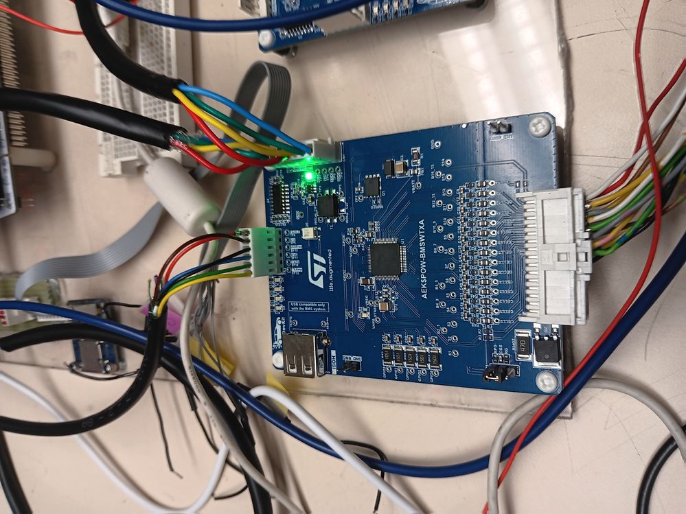

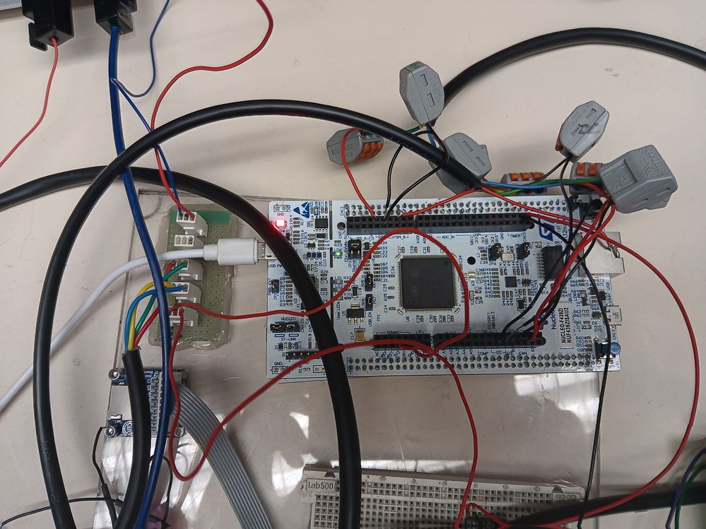

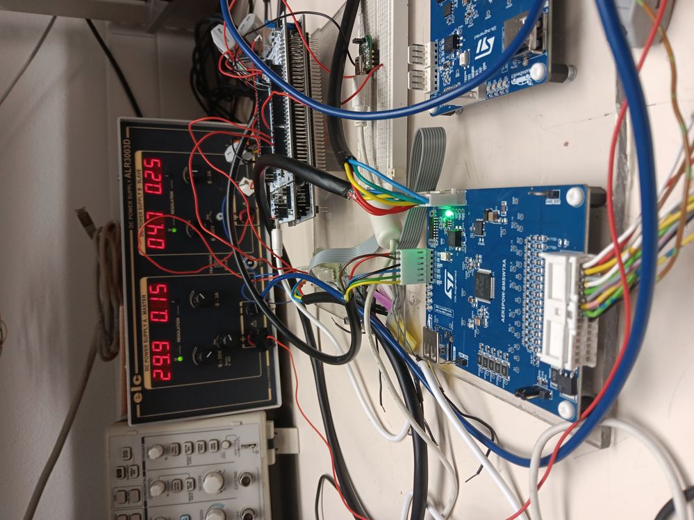

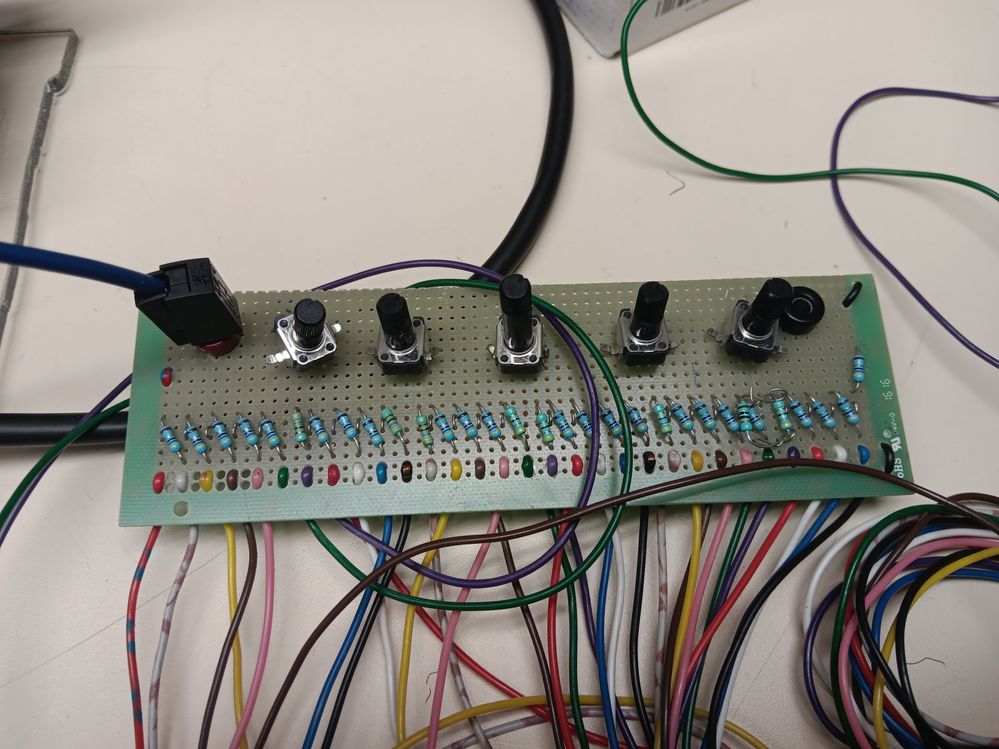

2026-02-16 5:51 AM
2026-02-16 5:56 AM
Hi @SRomeo ,
As you can see in the photos, I am using a voltage divider (resistors in series) to power the AEK-POW-BMSWTX. However, when I attempt to read the cell voltages via SPI using my STM32F439ZI, the readings remain at zero. This is because the L9963E node ID assignment is being rejected every time
Thank you for understanding.
Best regards !
