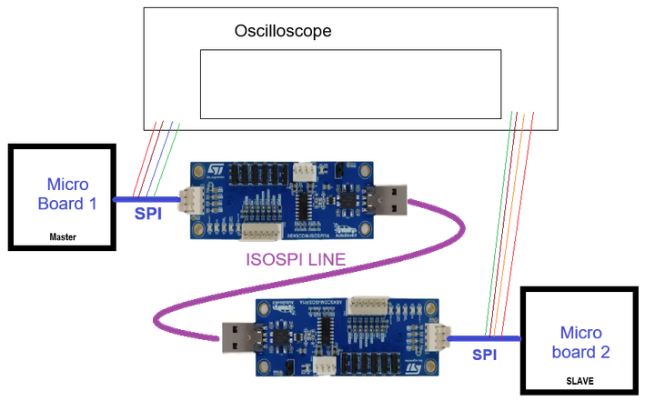

Let me help you checking what's wrong.
Use the scope to check SPI signals before and after ISOSPI transmission:
Compare those signals.
If the Signals are coherent, I think you have to adjust SPI software configuration of your Micro board n 2, because what changes is how each micro boards encode/decode data.
Best regards
Simone
OK, today i made measurements with oscilloscope on both sides in one time.
And then i find out when i played with oscilloscope probes.
When i removed probe from CLK test pin, the encoder side starts giving me correct data. Then i started to play around with probes and find out:
When probes were on CLK and MOSI pin - data not correct
When probes were only on CLK - data not correct
When probes were only on MOSI pin - data correct
Seems there are some disturbances in SPI signals but question is why the oscilloscope show OK signals on uC side  - only one clk cycle is data high and then encoder side gives me two clk cyles data high.
I will start to playing with pulldown resistor on MOSI line if i will get better results.

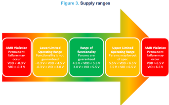

You can also try to monitor L9963T current absorption, checking if supply range fits the "range of functionality"
Anyway, I suggest taking a look to L9963T datasheet to check if you are encountering some edge cases.

Measured voltages with oscilloscope, dont see any glitches.
VDD=4.89VDC
VIO=3.33VDC
That would be in green working condition.
