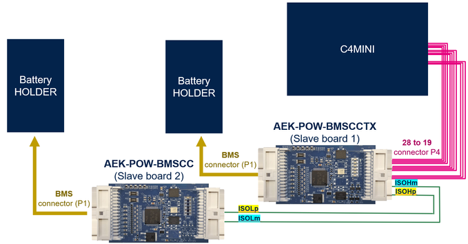

Hi there,
Regarding the connection, here follows a scheme for a "2 nodes BMSCCTX/BMSCC implementation using AEK-MCU-C4MINI"
Anyway,
we cannot give support on Raspberry/Python implementations.
L9963E (BMSCCTX's core IC) may be drived via AutoDevKit BMS APIs, so you should study on your own how to port AutoDevKit C examples and libraries into Python.
Best regards,
AEK_Team
