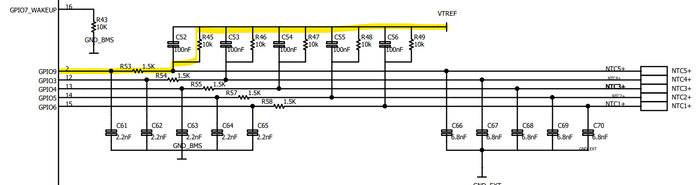

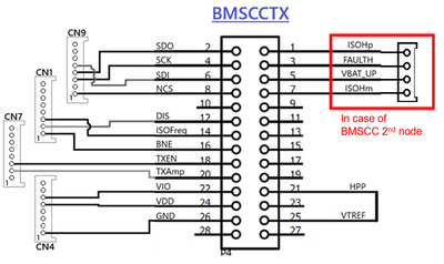

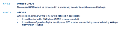

1) Actually, the L9963E datasheet paragraph you are pointing (6.10.2) make no sense on the current HW implementation. (AEK-POW-BMSCCTX).
If you look at the AEK-POW-BMSCCTX schematic:
GPIO3-4-5-6-9 are pulled-up to VTREF. No ground connection is required. You have to leave NTCx pins floating.
2) If you want to use current sense: R61=100ohm is the value configured into one of L9963E registers. This information is used by the IC to evaluate from the voltage between IsenseP/IsenseM, the current flowing.
For standard use you do not have to calculate any resistance at all.
If you do not use embedded current sense: Just stick to the scheme I've already shared, shorting GNDext to C0.

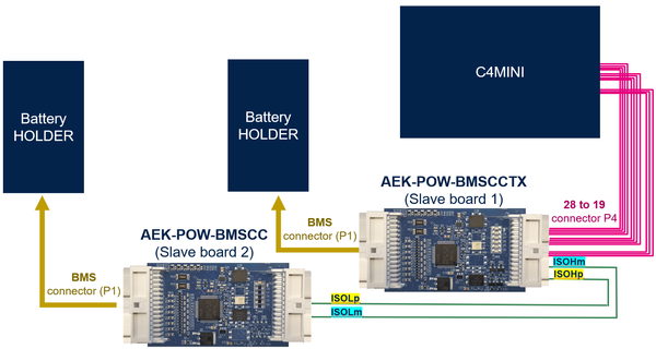

3) No. ISOH/ISOL are used to establish ISOSPI communication with another BMS board (AEK-POW-BMSCC).
This way you can connect up to 31 BMS boards in daisy chain, driving them with the same MCU board.
(2xBMS Nodes:    AEK-POW-BMSCCTX  +  AEK-POW-BMSCC  example)
Considering you have just 1 node (BMSCCTX) you can leave these pins floating.

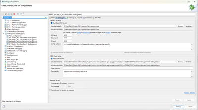

After that we followed the AEK-MCU-SPC5LNK_QSG_reduced.pdf guide, we installed the AEK_MCU_spc5LNK.bat file.

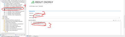

Then we opened the BMS-CCTX node project, went to build folder and found the "out.elf" file, we then copied the file path of it. We went into the "Debug mode" by clicking the bug icon on the top right. After that Clicked on the bug icon on the left with the down pointing arrow and pressed on debug configurator. There we went under "GDB OpenOCD debugging" pressed on SPC58ECxx (I believe you might have made a mistake here and chosen the wrong chip type, check you c4mini SPC58 chip, its most surely is the EC), after which we pasted the before copied path into C/C++ application.
The application was built and uploaded to the MCU. Make sure before you enter debugging you "build" and savethe project.

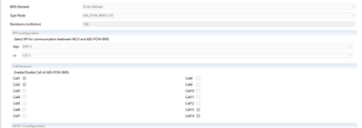

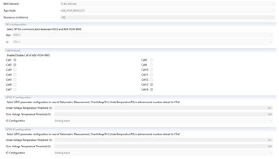

If you're using a custom cell amount (we are using 4), you have to change the settings of your bms. We did it as follows:
Disabled the cells we werent using, went down and changed the voltage levels to fit our cells. We didn't touch any other settings. After we did that we saved the project, pressed on "ALOCATE PINS", generate application code and compile application.

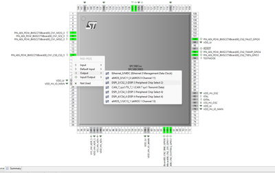

After which we went into PinMap editor, unassigned all of the allocated pins and opened a new application and copied the pin layout from the pre-built project there, making sure that while selecting the type of the pin(input,output, or I/O) select the coresponding type of the pin and their correct settings as shown below:
Generate, compile and go into debug- and debug. Should work now. Make sure all connections are correct. Also make sure to go into Board View and double check if all the pins on the MCU board are applied correctly.

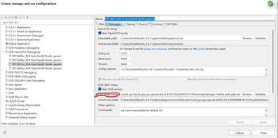

Also can u also share what did you gave in the executable name. Debug configuration->GBD OpenOCD debugging->SPC58ECxx_RLA AutoDevKit Studio generic->Debugger tab->GDB Client setup->Executable name.

C: AutoDevKitStudio-2.6.1\eclipse\plugins\com.st.tools.spc5.tools.gnu.gcc.ppcvle.win32_4.9.4.202504281937\toolchain\bin\ppc-freevle-eabi-gdb.exe
I think we had to re-select the same file, after that it worked (:

1. We are not using any NTC sensors right now as we have none (we just want to measure voltage for testing purposes), does that mean that we have to short all GPIO (3,4,5,6,9) to GND, or is just one enough?
Also to which pin can i short to GND? Can i just short it to pin GND_EXT?
2. For current sense to work I can just solder a 100OHM resistor to the R61 pad as shown before, or do I need to calculate the proper resistance for our 4 bat pack? If I do not want to use current sense (in our real application this will be done externaly via a hall effect sensor on the main busbar out), I understand that I have to short them but to what pin can i short them? Can I just connect it aswell to GND_EXT? Or do I need to connect them to GND_BMS? If this is the case then we don't have any proper isolation...

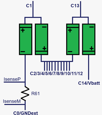

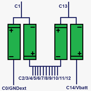

1) "less than 14 cells" battery packs requires ad-HOC wiring
L9963E (BMSCCTX core IC) requires at least 4 batteries to work properly, but batteries have to supply C0/C1/C2 - C12/C13/C14 BMS pins.
This means that the correct HW wiring for a 4cell battery pack is the following:

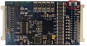

In case you want also to measure pack current, then you should mount R61 and add Isense wires as follows:
R61 value shall be set via SW in the configurator (default demo value=100ohm)

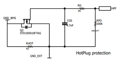

2) CLK behavior suggest no GND reference
This happens due to the HPP section (Hot plug protection) displayed below
HPP pin needs to be wired to one of the 2 reference voltages (VREG or VTREF) to assure ground continuity.
This should be your P4 configuration (heading to your C4MINI, assuming you are using the project: AEK-MCU-C4MINI - AEK_POW_BMSCCTX_GUI_application for discovery).

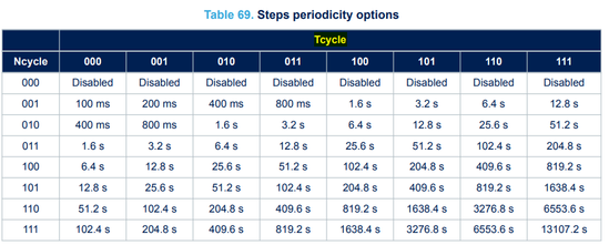

Regarding GPIO mode, it is better to set every unused GPIO into digital input mode (this way the IC wont' perform the voltage conversion procedure referred to that GPIO)
Ncycle and Tcycle are values that may span from 000 to 111.
The table you see in the BMS component allow you to set a specific timing for BMS cyclic conversion routine.
Based on the intersections of these 2 values you select the routine duration.
Tcycle = time of cycles  Ncycle = number of cycles
You can individually change the duration of some routines. In particular:
Tcycle_sleep: (used only when the IC is in cyclic wakeup, else Tcycle is used)
Ncycle GPIO thermal: *errata GPIO term, should refer to "GPIO terminal open" periodicity.
Ncycle cell thermal: *errata CELL term, should refer to "cell terminal open" diagnostic periodicity.
Ncycle GPIO: Refferred to GPIOs, the intersection with Tcycle define the ADC voltage conversion period.
Ncycle HWSC: Referred to HardWare Self Check, performs a BIST periodically, which trigger Configuration Override when a fault is percieved.
Ncycle Bal term: Referred to cell Balancing, balance terminal OPEN diagnostic periodicity.
For further information take a look to L9963E Datasheet

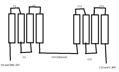

@SRomeo @ritehracingteam  I am trying to use 8 cells in BMSCCTX . As per Romeo's instruction, i connected the cells to the bms.
This is how i connected I shorted C4,C5,C6,C7,C8,C9,C10. I also shorted Isense+ and Isense- to GND_EXT as i am not using that.
When i connect this to my battery pack D2 lights up for only 1 min and then turns off. When i reconnect once more , same thing happens. Is there any wrong in the connection?

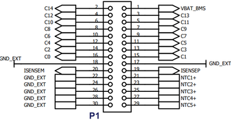

As can be seen from this pic (previously shared):
IsenseP/M are not mentioned.
In the correct HW configuration these two pins of the BMS connector are floating (not connected to anything). Connect just C0 to GND.
Anyway, this should not affect BMS behavior. (IC is waiting for SPI configuration, if not configured or kept alive, D2 switches off after a configured time)
