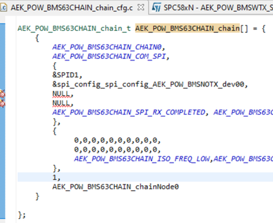

What should change from the demo application (apart from pin allocation) is just the following data field:
AEK_POW_BMS63CHAIN_node_num =  2
Please note that when a modification on a config file is done, you need to "save" and then "build" by using the Hammer icon (or else the code rerolls back to the default configuration)
Make sure your HW configuration is consistent with the suggested.
