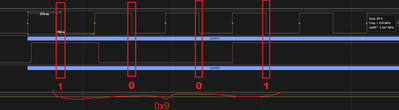

OK, i tried to send data from uC to encoder. And i get messy data at encoder side too.
I send data from uC 0x8080 and i get data to encoder 0x8181.
Encoder gives me reply 0x8100 and i get data to uC 0x0100.
I send data 0x8080 from uC every 80us. Then i receive same incorrect data to encoder side 0x8181 every time.
Encoder gives me reply data 0x8100 every time. I get incorrect data to uC (0x8080, 0x4100,0x8000,0x8180, C100, 0x8100,....)
See example from logic analyzer for one cycle.

As I see from this screen:
you are decoding your SPI data on CLK Rising edge (which is wrong)
In this specific example, if you decode on CLK Falling edge, the decoded data will be the following:
SRomeo_1-1756981958018.pngSo, based on what you expect, you should adjust the configuration of your analyzer.
There seems to be no problems on the signals whatsoever.
I suggest you to check also the SPI configuration of your micro board, making sure data decoding are consistent
Best regards,

Im sure that both CPOL=0 and CPHA=0 are configured in logic analyzer.
And my bad about configuration above, i see that i mistakenly write wrong values. Sorry about it because im little messy, i tried multiple combinations and still didnt figure it out.
At master side i have both:
TXEN=0
BNE=0
This gives me SPI mode 0 which is also configured on STM32G4 controller.
Best regards
Frank

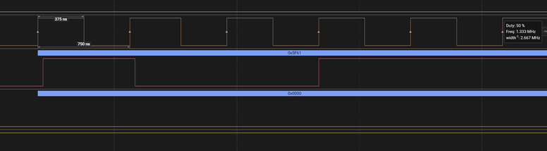

Thank you Ozone for suggestion.
Tried with lowest baudrate and problem persist.
Made some measurements with logic analyzer, see attachment.
ISOfreq=0
SPI clock to 250kHz
Best regards
Frank

Yeah, checked with oscilloscope, the signals seems to be good - see attachment.
Here i send 8 bit data for example. Microcontroller sends 0x01, and i get on other side 0x03.
Best regards
Frank
Which side of the isolator is that?
Can you view both sides at once?
