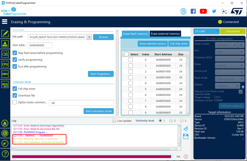

Why the NUCLEO-G431RB start programmer ,Warning:the core is locked up

Hello @Jzhan.8 ,
Did you check with other boards ? Maybe the problem is with your board !

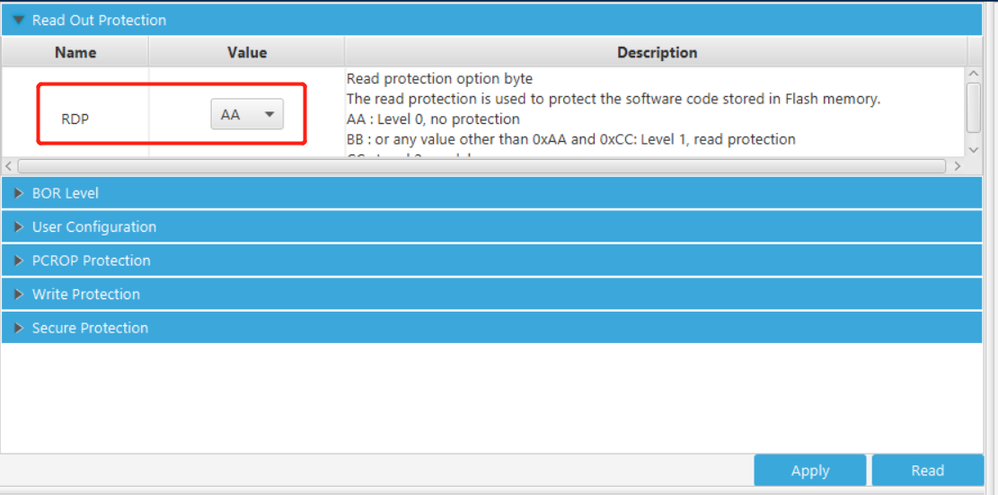

Otherwise, after choose AA value in Read Out Protection option, try select PCROP and uncheck the box, then click apply.
Please keep me informed about your update on this issue.
