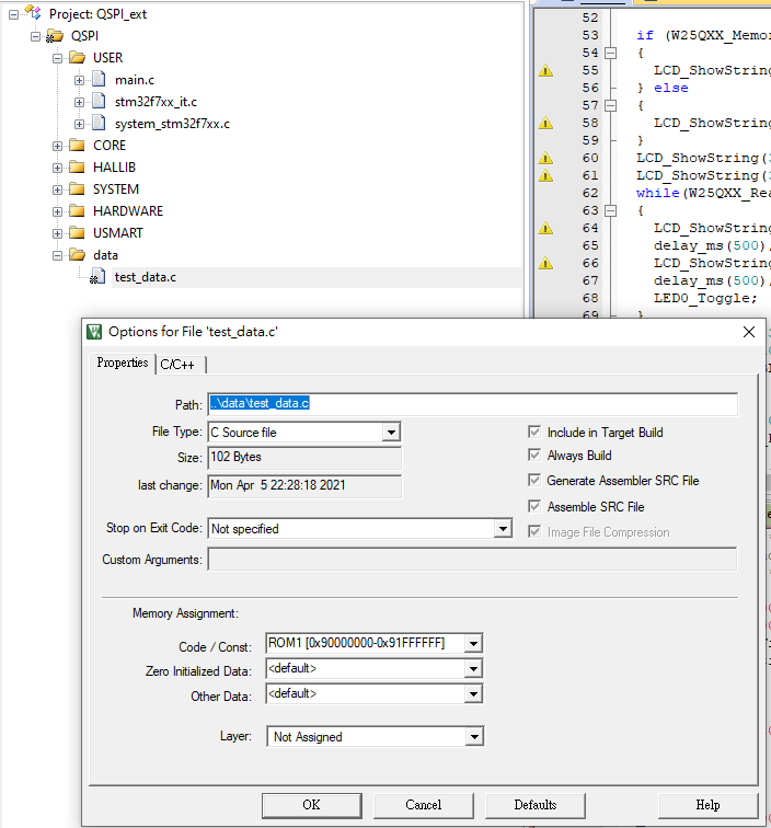

In order to test the external loader algorithm, I add a test data to a QSPI project that can be excuted correctly when downloaded to the internal flash. The test data will be written in the external flash via the external download algorithm.
0693W000008yjLQQAY.pngThere are two algorithms in the QSPI project, one is for internal flash and the other is for external flash

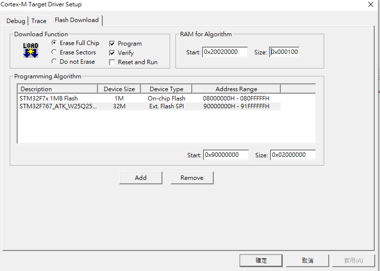

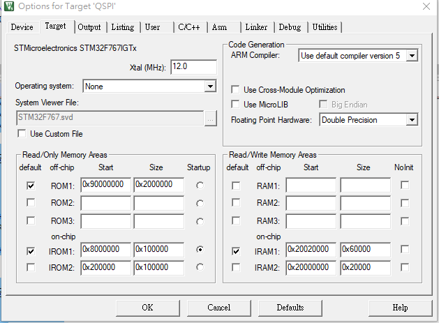

The setting of target option in the QSPI MDK project is shown as following:
0693W000008yjLzQAI.png And the scatter(QSPI.sct) file is shown as following:

0693W000008yjMOQAY.pngIt shows that Erase Chip and Program are done, but encounters errors “Contents mismatch at: 08000000H (Flash=00H Required=70H) !�?while Verifying.

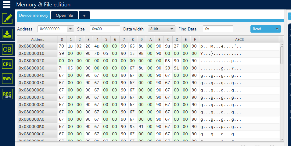

I use CubeProgrammer to read interal flash, it shows that the data the internal flash is correctly. I suggest that the Verify function for internal flash is not running properly.
