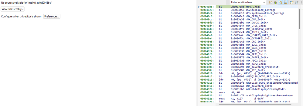

Hi everyone,
I’m currently trying to debug my project. However, as soon as I start the debugger, I always get the following error message: "No source available for main() at 0x80048bc". I’m using a custom board with an STM32L4P5ZGT6.
Read and followed these threads: https://community.st.com/t5/stm32cubeide-mcus/how-to-solve-the-error-quot-no-source-available-for-main-at-quot/td-p/228420
and https://community.st.com/t5/stm32cubeide-mcus/debug-quot-no-source-available-for-main-quot/m-p/385835
I ensured I’m using the Debug build configuration and set Debug Level to -g3.
Any Ideas how to fix this?
Thanks in advance.
Simon

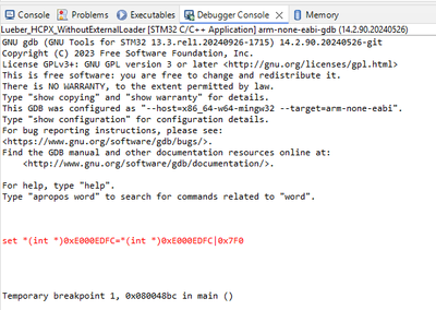

How are you starting the debugger?
Does the Console tab show the programmer downloading the ELF to the chip?

I start the debugger via the Debug Configurations I want to make sure the Debug build is selected and the correct launch file is used.
Flashing works, but as soon as the program is programmed onto the target I get the “No source available” message.
I’m using FreeRTOS and external memory (QSPI). Could this be related?
