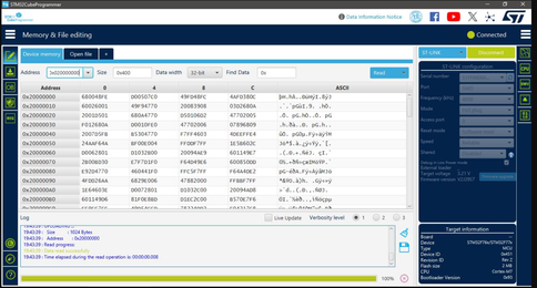

Hello @Hans T,
Not being able to read SRAM @0x20000000  via USB is expected since the first 16KB are used by bootloader code and are not accessible. You can successfully read SRAM contents starting from @0x20004000.
The "Not connected" not toggling is just a GUI bug and will be fixed in a future release. To work around the button freezing, you can perform a read operation.

Can you type in Read Address the RAM address @0x20000000 :  and see/send  the message/log after reading ?

I can't read the data with USB,
But parallel with the JTAG interface in HOTPLUG mode, I read this:
