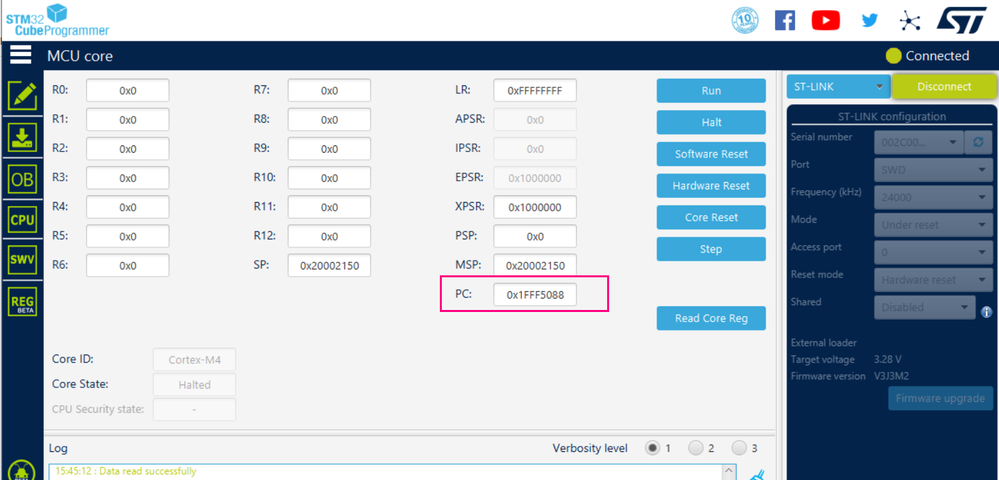

Hi @MZoto.1​ ,
Thanks for your feedback.
First of all you have to check that you are booting on bootloader.
To do this you can connect to SWD interface with STM32CubeProgrammer and use the MCU Core Register panel where you have to read the PC content.
- if you are booting on Bootloader you will see an address starting by 0x1FF.
- if the PC contains other addresses like 0x08xxxxxx that's mean that you are booting on flash.
This will help us to guide you in understanding the problem.
