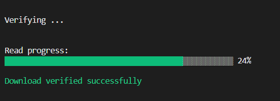

When using the command line version of STM32CubeProgrammer, I notice during the verification process (-v flag), the progress bar follows a sequence like 6%->12%->18%->24%-18%->24%... and ends at 24%, with a successful verification. Picture provided for clarity. I am using STM32L021F4 and STM32CubeProgrammer version 2.3.0.

​Hello @jefflongo​ could you please share your .bin file ?
Thanks,
Khouloud
‎2020-01-24 10:35 AM
It won't let me directly upload a .bin file here so here is a link to the file. https://drive.google.com/open?id=1n2rCVDJbXuzldvBVJdc3xlPtuQ_NqnkI
‎2020-01-28 12:27 AM
​on my side it works fine , so could you please give me the log contents with Verbosity level 3?
Thanks,
Khouloud
‎2020-01-28 8:19 PM
@Khouloud ZEMMELI​ Here is the output. Thanks for continuing to look into this.
‎2020-02-05 2:12 AM
​Seems ok from your log file.
So from which tool you launched the CLI ?
Best Regards,
Khouloud
‎2020-02-05 2:19 AM
I'm running it from Git Bash terminal on Windows using the command​
STM32_programmer_cli.exe -c port=COM6 -w stm32dev.bin 0x08000000 -v -vb 3
Although I have tried several other terminals with similar results. I've also tried running it on a Linux machine with the same result.
‎2020-02-05 7:02 AM
​Issue reproduced, @jefflongo​ it will be fixed in the next release.
Best Regards,
Khouloud
