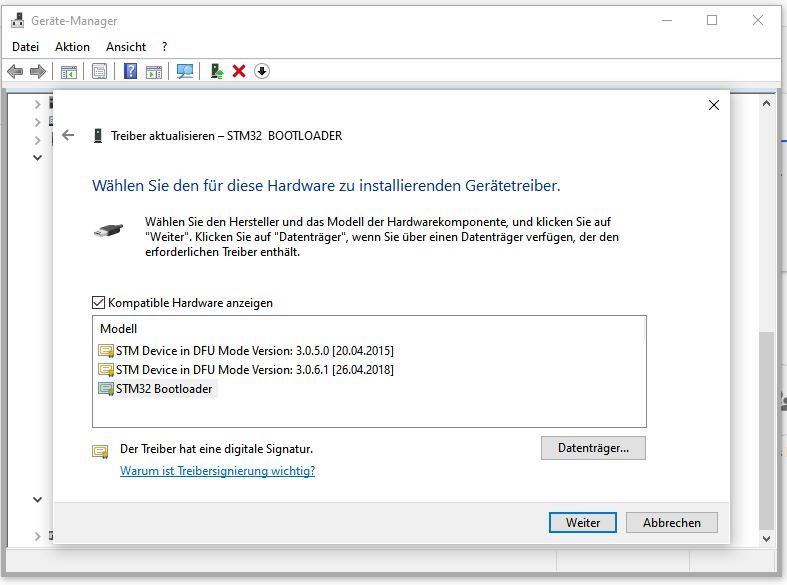

Since i installated STM32CubeProgrammer the DfuseDemo no longer works.
I found out that the driver is the Problem.
When i use "STM32 Bootloader" --> STM32Cubeprogrammer find the µC but DfuseDemo don´t.
When i use "STM Device in DFU Mode Version: 3.0.6.1" --> DfuseDemo find the µC but STM32Cubeprogrammer don´t.
In the development department we use stm32cube programmer. However, dfuseDemo is to be used in other departments and by the customer.
Is there a possibility to use both software without changing the driver?
Could the latest versions of the programs agree on one (or both) drivers?

Hi @mfrank9 ,
DfuseDemo and STM32Cubeprogrammer drivers are incompatible so it is not possible use both without changing the driver.
Is there any reason to use DfuseDemo ?
I recommend you to use STM32Cubeprogrammer for all your tests, if there is any limitation when using STM32CubeProgrammer, please come back to us and we will help you.

2021-01-15 5:22 AM
Hi
the STM32Cubeprogrammer has no limitation.
But if we send an newer Software to our constumers we need a software which is easy to use.
STM32Cube has some settings where the customer shouldn't change anything.
We need a simple software which can only update the controller without many buttons.
DfuseDemo is perfekt for this case

Hi @mfrank9 ,
Certainly, Cubeprogrammer contains more features but it still easy to use :)
If you want to use the software without buttons , the command line STM32CubeProgrammer_CLI is also available with many options , It's possible to do all operations (download, modifying option bytes) using CLI.
