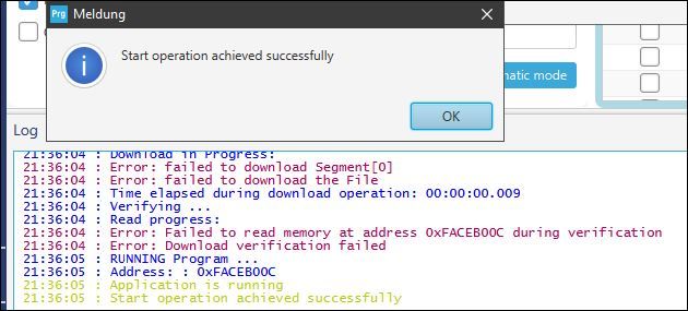

Tried to download the Atollic ELF file via STM32 Cube programmer. "download failed" Converted to hex and tried to download. "Download failed". Why I can't download hex files produced by Atollic?

Without knowing the part, or seeing the ELF/HEX file, I'd have to assume you've built the code for the wrong address.
Can STM32 Cube Programmer read the part? Save a .HEX file? Load/write that .HEX file?

Its Nucleo H743ZI.
Address FACEBOOC a joke?
Probably to someone. @Nawres GHARBI​
Seems to load in v1.1.0 Ok might look at an NUCLEO-H743ZI with a newer build later if I have time.

Hi @Ggast​
Could you attach the .elf or .out please ?
If fact this not a joke, 0xFACEB00C is used to init a pointer with a dummy value for debug stuff.
We used this value to catch a bug, so it will be helpful to have your .elf
