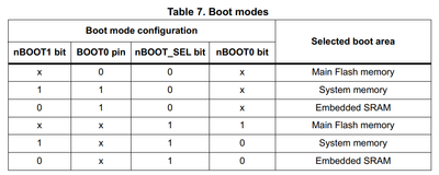

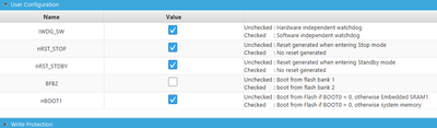

I will configure the boot mode in the option bytes of the STM32G030F6. Now I see only the nBOOT1. I missing the nBOOT_SEL and nBOOT0.
In the refernce manual are describe all:
How can I cinfigure it?

I've found out that the programmer use the false device:
I've use a NUCLEO--L073RZ and connect the ST-Link to my hardware with a STM32G030. Can I change the device configuration?
‎2024-06-12 1:00 AM
STM32CubeProg recognises which target is connected to it via the ST-LINK.
Are you sure you have removed the two jumpers on CN2 so that the STM32L073 is no longer connected to the ST-LINK?
Regards
/Peter
‎2024-06-12 1:44 AM
Thanks Peter Bensch,
that was the problem. I have removed the SB12..15 but this two line not. So now I have the correct device and see the correct boot mode flags.

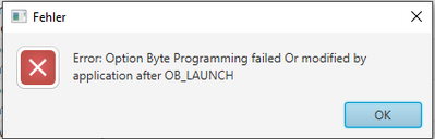

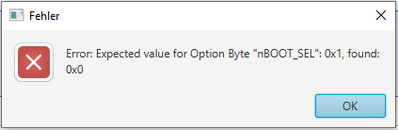

Now I will change the nBOOT_SEL to 1. After press "Applay" I become a error message:
And it is not changed. After press "Read" it show for me correct but after a POR it is not changed.
What must I do that work this correct?

‎2024-06-12 1:48 AM
Oh, I've vorgot my function in the application. I must remove it, it overwrite this.
Not it works fine :)
