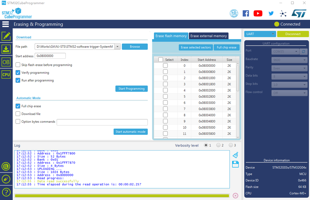

Hi everyone,
I use a JumpToBootloader( ) function in my code to execute system memory bootloader. and then STM32CubeProgrammer connect ok, but it can not program
MCU:STM32G030K6T6 STM32CubeProgrammer: v2.4.0
Boot Interface: UART1 (PA9 PA10)+MAX13487EESE(RS485 witch AutoDirection Control)
here is JumpToBootloader(void)
static void JumpToBootloader( void )
uint32_t i = 0;
void ( *SysMemBootJump )( void ); /*declare a function pointer 声明一个函数指针 */
__IO uint32_t BootAddr = 0x1FFF0000; /* BootLoader address*/
/*Turn off global interrupts 关闭全局中断 */
__disable_irq();
/* Turn off the tick timer, reset to default 关闭滴答定时器,�?�?到默认值 */
SysTick->CTRL = 0;
SysTick->LOAD = 0;
SysTick->VAL = 0;
/* Set all clocks to default state, use HSI clock 设置所有时钟到默认状�?,使用HSI时钟 */
HAL_RCC_DeInit();
/* Disable all interrupts, clear all interrupt pending flags 关闭所有中断,清除所有中断挂起标志 */
for ( i = 0; i < 1; i++ )
NVIC->ICER[i] = 0xFFFFFFFF;
NVIC->ICPR[i] = 0xFFFFFFFF;
/* Enable global interrupt 使能全局中断 */
__enable_irq();
/* Jump to the system BootLoader 跳转到系统BootLoader,首地�?�是MSP,地�?�+4是�?�?中断�?务程�?地�?� */
SysMemBootJump = ( void ( * )( void ) ) ( *( ( uint32_t * ) ( BootAddr + 4 ) ) );
/* set the main stack pointer 设置主堆栈指针 */
__set_MSP( *( uint32_t * )BootAddr );
/* Jump to the system BootLoader 跳转到系统BootLoader */
SysMemBootJump();
while ( 1 )
there is STM32CubeProgrammer log:
17:12:49 : Disconnected from device.
17:12:50 : Serial Port COM35 is successfully opened.
17:12:50 : Port configuration: parity = even, baudrate = 9600, data-bit = 8, stop-bit = 1.0, flow-control = off
17:12:51 : Timeout error occured while waiting for acknowledgement.
17:12:51 : Activating device: OK
17:12:51 : Chip ID: 0x466
17:12:51 : BootLoader protocol version: 3.1
17:12:52 : UPLOADING OPTION BYTES DATA ...
17:12:52 : Bank : 0x00
17:12:52 : Address : 0x1fff7800
17:12:52 : Size : 52 Bytes
17:12:52 : Bank : 0x01
17:12:52 : Address : 0x1fff7870
17:12:52 : Size : 4 Bytes
17:12:53 : UPLOADING ...
17:12:53 : Size : 1024 Bytes
17:12:53 : Address : 0x8000000
17:12:53 : Read progress:
17:12:55 : Data read successfully
17:12:55 : Time elapsed during the read operation is: 00:00:02.257

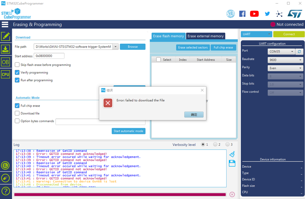

17:13:33 : Memory Programming ...
17:13:33 : Opening and parsing file: SmokeSensorUnit.bin
17:13:33 : File : SmokeSensorUnit.bin
17:13:33 : Size : 28391 Bytes
17:13:33 : Address : 0x08000000
17:13:33 : Erasing memory corresponding to segment 0:
17:13:33 : Erasing internal memory sectors [0 13]
17:13:33 : Download in Progress:
17:13:35 : Error: Write Command not acknowledged at address 0x8000000
17:13:35 : Error: failed to download Segment[0]
17:13:35 : Error: failed to download the File
17:13:35 : RUNNING Program ...
17:13:35 : Address: : 0x08000000
17:13:35 : Error: START command not acknowledged!
17:13:35 : Error: Start operation failed
17:13:37 : Timeout error occured while waiting for acknowledgement.
17:13:37 : Error: GETID command not acknowledged!
17:13:37 : Reemission of GetID command
17:13:38 : Error: GETID command not acknowledged!
17:13:38 : Reemission of GetID command
17:13:39 : Timeout error occured while waiting for acknowledgement.
17:13:39 : Error: GETID command not acknowledged!
17:13:39 : Reemission of GetID command
17:13:40 : Timeout error occured while waiting for acknowledgement.
17:13:40 : Error: GETID command not acknowledged!
17:13:40 : Reemission of GetID command
17:13:41 : Timeout error occured while waiting for acknowledgement.
17:13:41 : Error: GETID command not acknowledged!
17:13:41 : Warning: Connection to device 0x466 is lost
17:13:46 : Disconnected from device.
17:13:46 : ST-LINK error (DEV_USB_COMM_ERR)
2022-06-24 4:46 AM
STM32CubeProgrammer: v2.4.0 very old buggy , try latest.
2022-06-26 6:42 PM
Hi MM..1
Thanks for reply, i try STM32CubeProgrammer: v2.10.0(latest version), connect ok , failed to program again.
