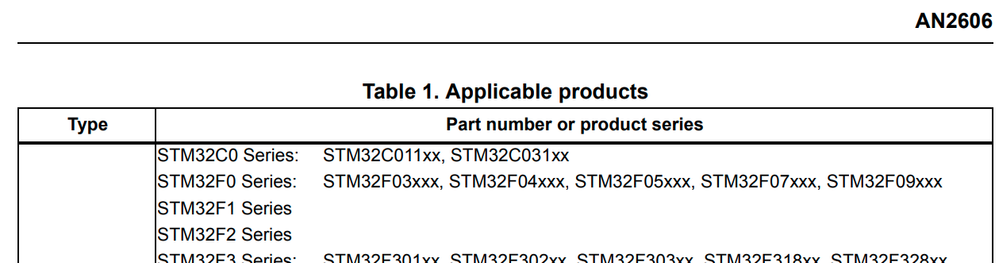

My main application which highly relies on USART1 works as expected. So I don't think there is an issue with the USART pins or PCBs I've used. STM32F103 is not listed in AN2026 AN2606, so is there any chance that particular model doesn't have a ROM bootloader?

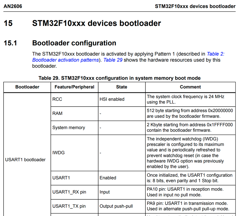

> STM32F103 is not listed in AN2026, so is there any chance that particular model doesn't have a ROM bootloader?
You mean AN2606? I think "STM32F1 Series" means it applies to all STM32F1 chips.
In any case, the various STM32F1 bootloaders are in the document.
Are you using the pins listed in the document?

Yes, I mean AN2606. Sorry for the typo.
I am using the pins listed in the document. After a few tries, I found out there is something wrong with my USB-TTL converters or related drivers. The third USB-TTL cable worked for me and I am able to use the bootloader. I use the other USB-TTL cables for various projects and they worked just fine until now. Maybe there are more strict timing requirements with the bootloader which I do not aware of and converters struggled with them. Everything seems fine now. I was just unlucky with my equipment.
