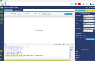

I am using STM32CubeProgrammer 2.4 version on a PC (let me call it PC_1, Windows 11 Enterprise OS) for programming a board (a customized seld-developped one) where there is also the STM32CubeIDE SW for FW development. You see below the program screen

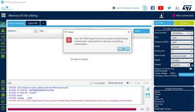

On a second PC (let me call it PC_2, Windows 10 Enterprise OS) I installed STM32CubeProgrammer 2.16 version:
in this case I am not able to connect (for programming) the same board (with the same ST-LINK V2 device and cable) I am able to program on PC_1 with STM32CubeProgrammerr 2.4. You see below the PC screen:
NO STM32 target is found!!
Note that before making the connection, by clicking on the left button on Serial Number row the program is able:
to detect the presence/absence of the STLINK device;
to detect the target voltage (when powered on/off)
but the connect operation does not work.
How can I solve this problem?
Thank in advance for your help
Mario

Hello @MSand.1,
I apologize for the late reply,
Could you try using CubeProgrammer v2.17 and get back to us with the results ? We are not able to reproduce on our side.
Aziz
