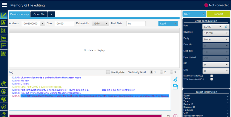

I am using STM32H563ZI board and trying to develop a UART communication project but I just can't figure how to connect to STM32CubeProgrammer threw UART and always get the error:
" Error: Activating device: KO. Please, verify the boot mode configuration and check the serial port configuration. Reset your device then try again... "
I am having a issues with the UART in general and can't figure out how to transmit data correctly.

The chip must be in bootloader mode before you try to connect. You can do this by holding BOOT0 high during reset. There are other ways as well, outlined in AN2606.
You must connect to pins that are supported by the bootloader, as described in AN2606.
The bootloader using even parity, not none.
STM32 microcontroller system memory boot mode - Application note
As an aside, it will be more productive to use an SWD connection to develop your application as it allows for a richer set of programming and debugging features.
