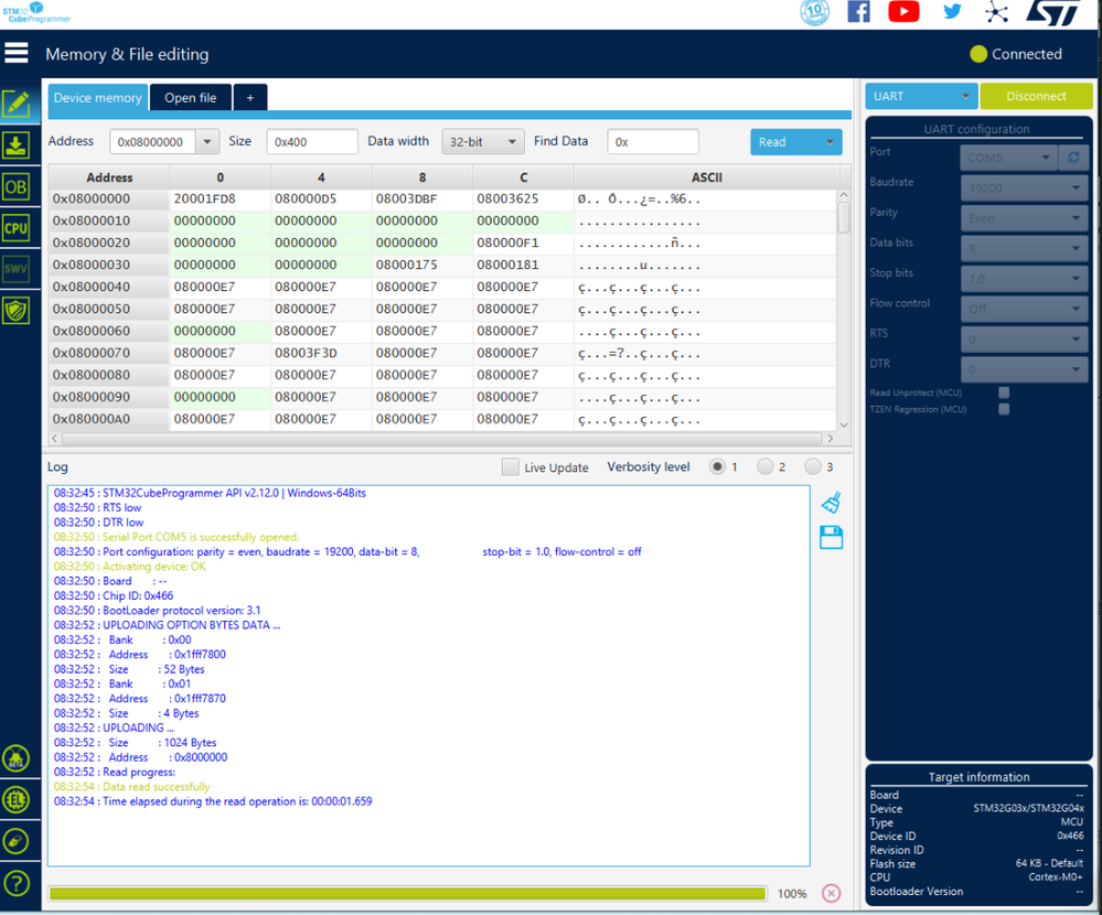

Recently I used Stm32cubeprogrammer to write programs via UART. I can connect to the MCU, I can also read the data, but the download fails.
Have you encountered similar problems?

Hi @Community member,
the SWP connection works?
Have you tried reading the OB to see if there is something preventing erase or write in the flash?

I can read and write using the SWD interface, but not with UART

Could you share a screenshot of STM32CubeProgrammer GUI when connected via ST-LINK (To know the bootloader version and the rev ID) ? Could you also specify the full name of the device you're using ?
A verbose 3 log could be useful as well.

The chip model I use is STM32G031G8U6.

Hello @Community member,
There are some limitations in the earlier versions of the bootloader, especially on packages with less than 32 pins (you can check AN2606 page 225 for further details). If you have bootloader V5.2, I suggest keeping PA3 at high level and doing the test with UART1 (PA9, PA10).
