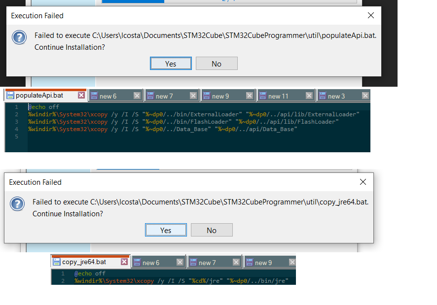

LCost.2
I also had the same issue, and even trying the solutions mentioned by @ARich.6​ , it still didn't work.
The installer was showing these 2 errors, when running copy_jre64.bat and populateApi.bat.
Basically what these batches do is simply copying some folders (External Loader, Flash Loader, Data_Base and the famous bundled "jre" folder) into their respective subfolders.
So basically, during the installation, when the error occurred, I copied them manually to their respective destination folders inside "C:\Program Files\STMicroelectronics\STM32Cube\STM32CubeProgrammer".
Populate_api.bat:
"%~dp0/../bin/ExternalLoader" "%~dp0/../api/lib/ExternalLoader"
"%~dp0/../bin/FlashLoader" "%~dp0/../api/lib/FlashLoader"
"%~dp0/../Data_Base" "%~dp0/../api/Data_Base"
copy_jre64.bat:
%windir%\System32\xcopy /y /I /S "%cd%/jre" "%~dp0/../bin/jre"
For a clearer picture of where the origin folders are, set "@echo on" on both of these files and run the installer again.
As you can see, one of failed copies was the "jre" folder, and that is why the error occurs when starting the STM32 Cube Programmer Environment.
