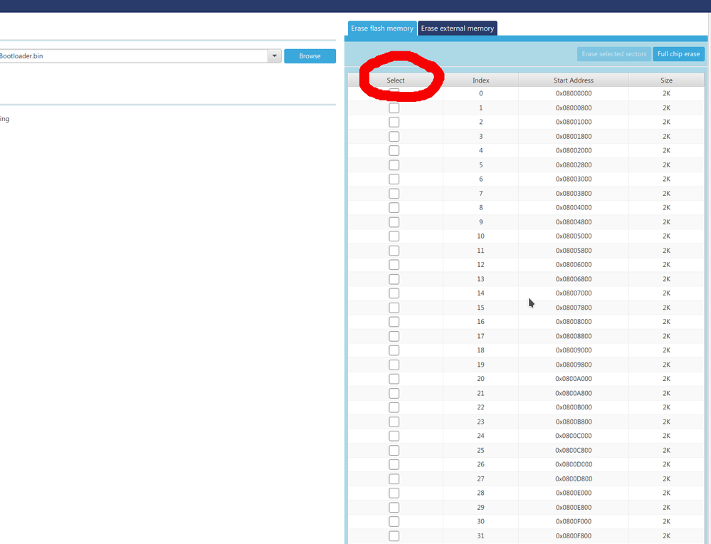

Dear STM32CubeProgrammer Developers,
I would recommend to add a select all checkbox/context menu to the page selector of the Erase flash memory table view:
I have a 2 sector wide EEPROM emulated area at the end of the flash what I would like to preserve during the erase operation, and to do so I need click all the 30 items. If a select all feature would be implemented I would only need to select all and untick the last two.
Thanks in advance!

The version 2.2.0 of STM32CubeProgrammer is on the web, and it implements this request.
Please check it.
-Amel
Thanks, I verified it with a Nucleo-G070, works great.
Many thanks for getting this implemented!
