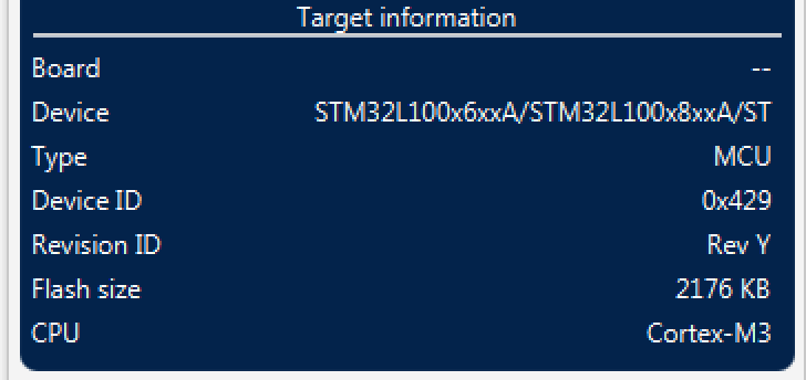

Now, if I open the STM32CubeProgrammer v2.1.0, open the same file RAK5205_Blink.hex, the ST-Link v2 is recognized and connected correctly, read the memory of the MCU without problems, but when I want to program it in the same way than before, it shows the error, "Flash loader can not be loaded".
What is the difference between the ST-Link Utility and the STM32CubeProgrammer regarding device detection and programming?
What exactly does the error"Flash loader can not be loaded" means?
One difference I noted is that the STM32CubeProgramer, detected the Device as STM32L100x6xxA / STM32L100x8x ... with a Flash Size of 27520 KB instead of 128KB that has the MCU, different from what it is detected with ST-Link Utility.

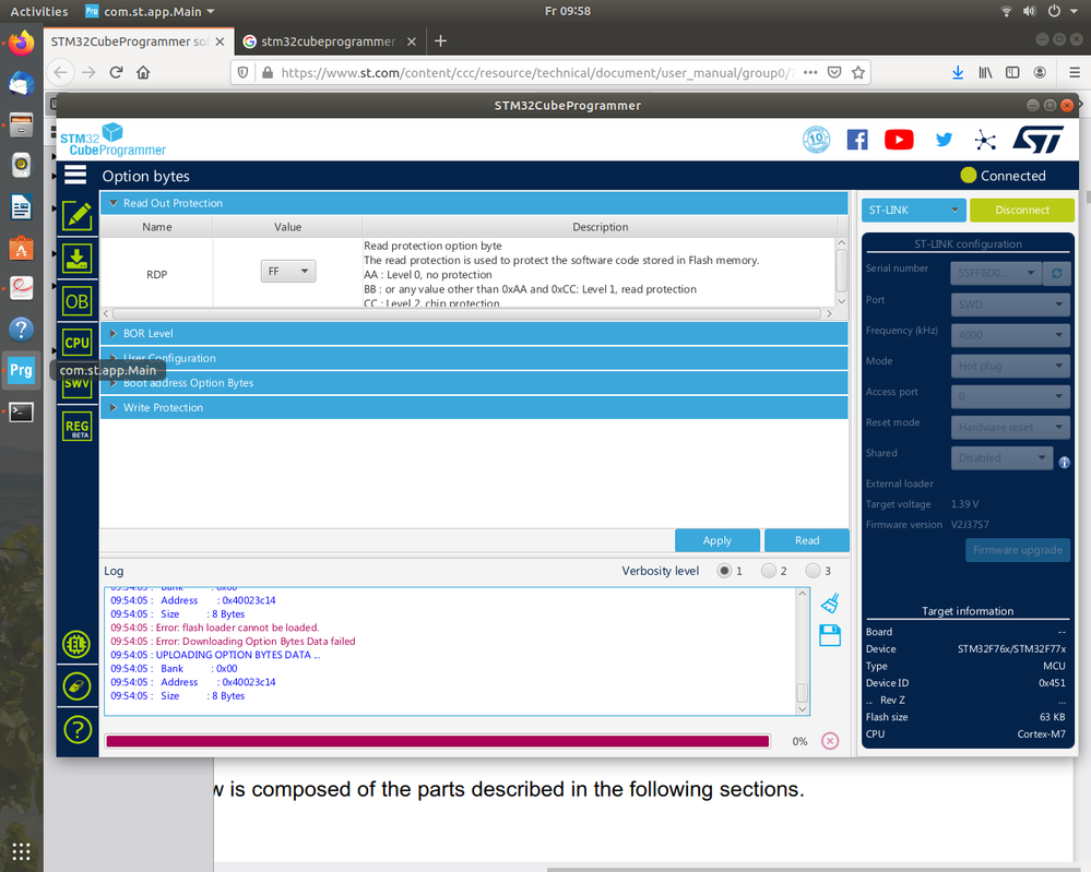

I have also the same problem
All the people on the thread have STM32L1 parts, running Windows, so I suspect you actually have a different problem
https://community.st.com/s/question/0D53W00000VivMBSAZ/access-the-flash-memory-from-stm32f767bi
The interaction with the device looks to be broken, so I'd assume some low-level drivers on the ST-LINK side.
Did the new version or the patch offered work?
Is the failure only in Ubuntu? Or did it follow you to Windows too?
LucHardware
In the Terminal "LSUSB" I find "ID xxxx:xxxx STMicroelectronics ST-LINK/V2". Some pages from the STM32F767BI are readable. I already install the latest linux driver for the ST-LINK/V2 version 1.0.3-1 from the packet en.stsw-linl007_V2-38-27.zip (other versions are windows only).
LucHardware
Still no sollution. They mention on google about st-link utility but this is integrated in the STM32 IDE.
