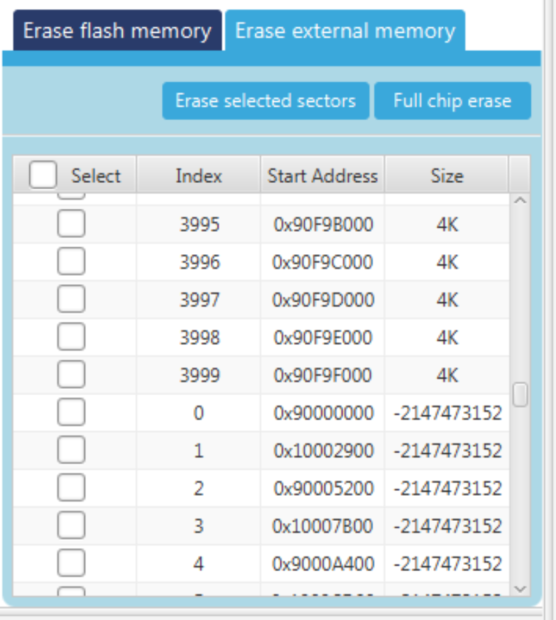

I have come across a couple of bugs whilst developing an STLDR for external flash access, note the memory arrangement of the flash used is 4096 4K sectors (MX25L12833F 16MB). Bugs:
  • Under 'Erasing & Programming' not all sectors can be listed and individually erased under the 'Erase external memory' tab. When loading this view the following error is shown: External loader sector number is too big, displaying only the first 4000 sectors. The sector list is also corrupt after index 3999 showing invalid adresses and sizes:0693W000000VN9wQAG.png

You say you have tested with an STM32F469NIH6, did you pair this with external memory which has a sector count greater than 4000?
The issue I am seeing is with the management of exteral memory not the ST MCU flash.

Hi @JHedges​ , @Nesrine.JLASSI​
I have the same problem with a Nucleo-L432KC and a Winbond W25Q128JV (size is the same as @JHedges​ ).
The total number of sectors cannot be displayed by CubeProg. However I can't remember if the display gets corrupted afterwards or not.
@JHedges​  regarding your second issue, did you implement the mass erase function in the code ? Because when I ask for a full chip erase, the loader calls mass erase, not sector erase with sectors ranging from 0 to the max number...
