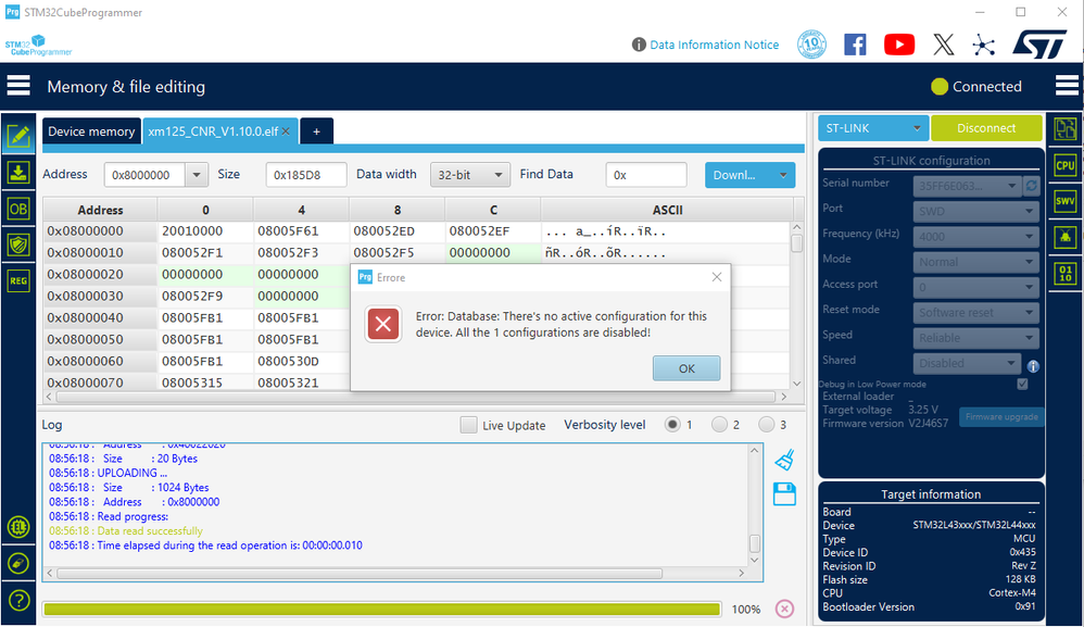

This is a big problem.

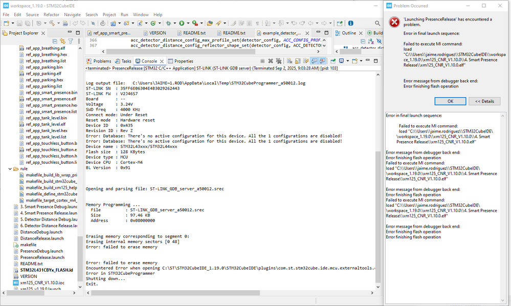

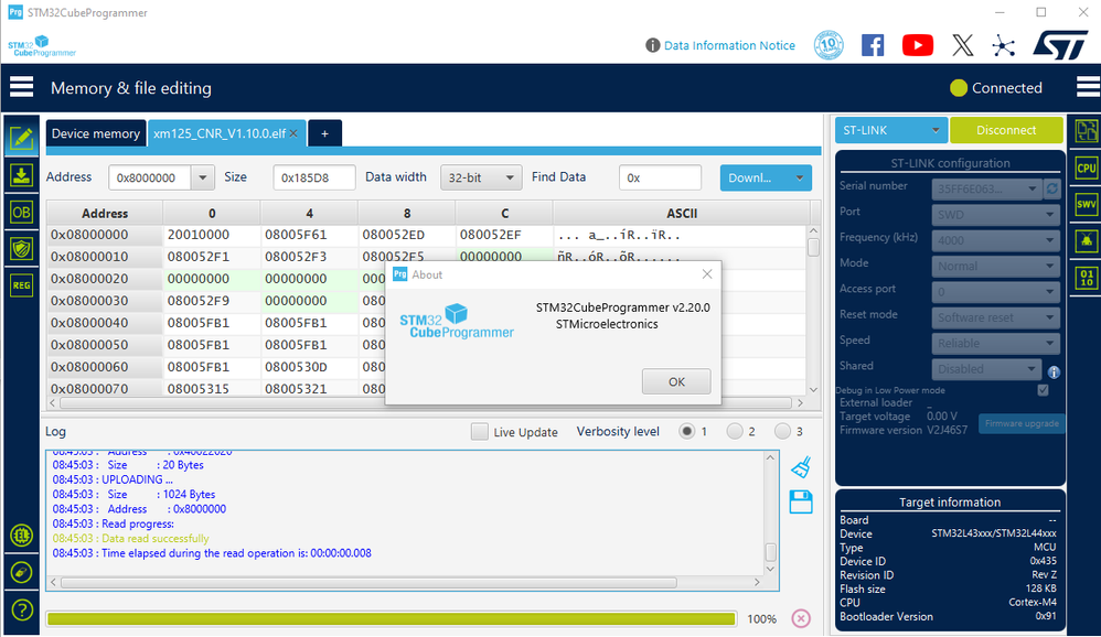

I'm currently having the problem with both versions: STM32CubeIDE v.1.19.0 and STM32CubeProgrammer v.2.20.0 for the STM32L431CBY microcontroller. See the images below.
Could you please suggest a solution as soon as possible? As you can understand, we have deadlines, and this issue has been pending for months!

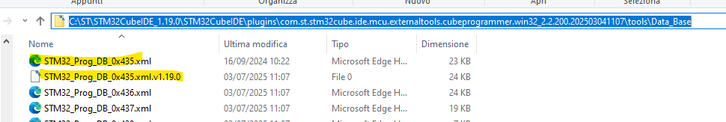

I am writing to share a temporary solution for the STM32L431CBT6 MCU (ID 0x435) issue.
I was able to resolve it by using an older DB file from STMCubeIDEv.1.16.1. This file is attached for your convenience.
To implement this solution, please rename the original file and copy the attached file into the following directory: C:\ST\STM32CubeIDE_1.19.0\STM32CubeIDE\plugins\com.st.stm32cube.ide.mcu.externaltools.cubeprogrammer.win32_2.2.200.202503041107\tools\Data_Base
I hope this helps others facing similar issues while ST works on a permanent fix for their "Configurations."
