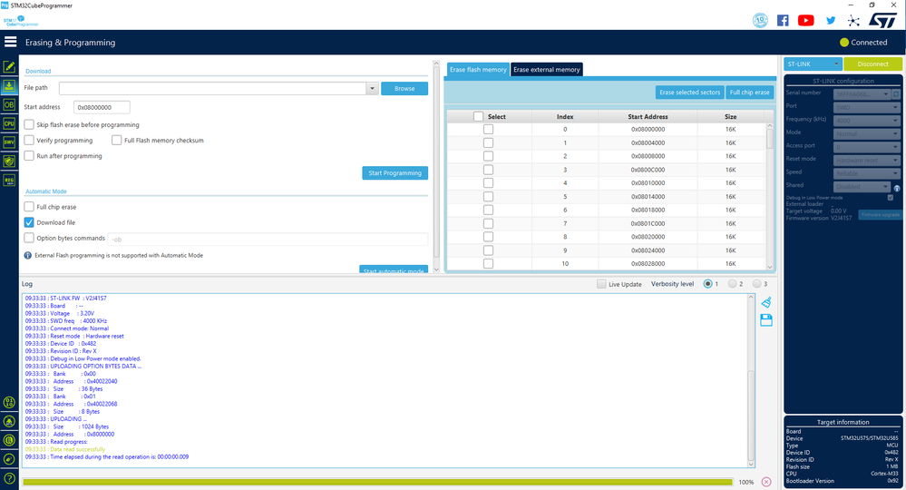

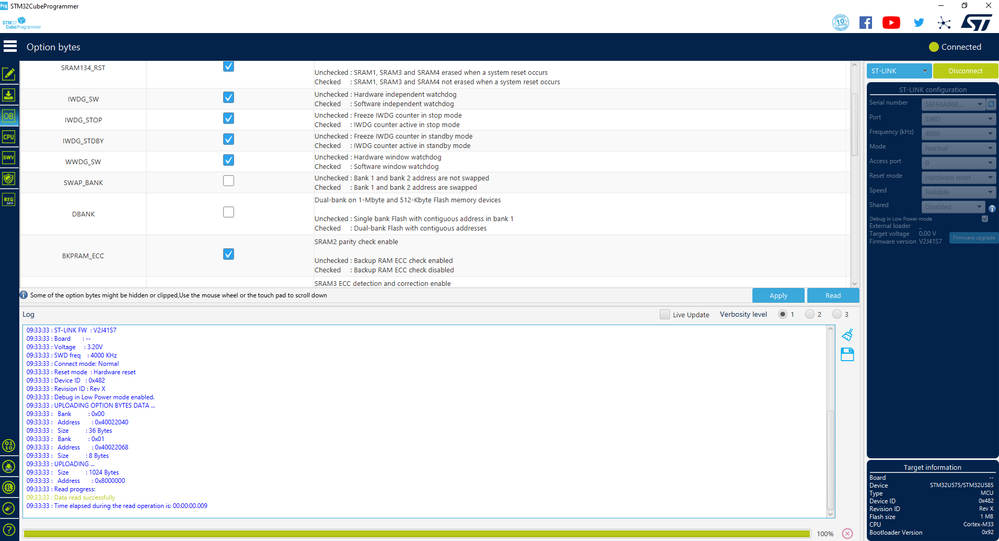

Does anyone are able to erase a memory page of BANK2 on a STM32U575 with ST-LINK/V2 in STM32CubeIDE or STM32CubeProgramer? The mcu is configure in dual bank by default. I'm only able to work with a SEGGER JLINK (in IDE) or it is possible to program mcu after a full chip erase. When I put it in single bank mode, the IDE only erase 8K of the 16K page and generate an error at verification.
Thanks

Hmmm. In documentation U575 say that "page have 8K" not 16K? Perhaps you use wrong linker script?

Or settings your debugger/programmer are wrong :)

Here is a snapshot of the programer.
When I uncheck the DBANK Option like next picture.
