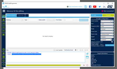

ST Link not recognizing STM Cube Programmer? - From screenshot you can see pulls up single character serial number and has no target information. I can (and did) upgrade firmware to latest on ST Link. Downloaded all drivers etc. Still won't connect. Keep getting "UR connection mode is defined with the HWrst reset mode" log entry.
14 replies
August 9, 2023
Tried changing "Shared" to enabled. The single character serial number disappears and is replaced with "No ST-LINK Detected." Tried changing "Reset Mode" to "hardware Reset"- nothing

Serial Number suggests you have a fake / counterfeit device, ST is not supporting them.

Single character serial numbers are highly suggestive of counterfeit ST-LINK's. You have a picture of the back label on the device?

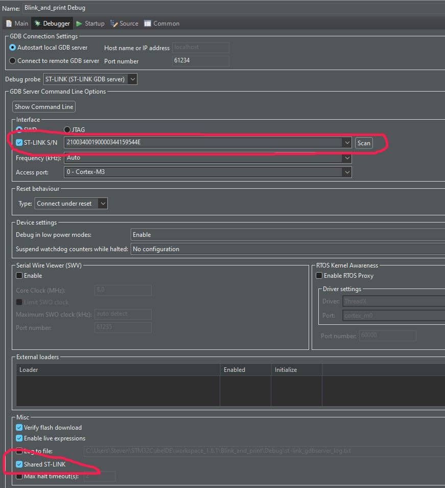

I have the same problem, my fake STLink V2 has only the ! character as a serial number. I think STM32CubeProgrammer will not work with a device without a reasonable serial number BUT the STLink Utility does; you can download it here: https://www.st.com/en/development-tools/stsw-link004.html it's not as capable as STM32CubeProgrammer but is OK for uploading/downlaoding firmware.  Also as others have pointed out if the SHARED option is enabled in STM32CubeProgrammer and the REFRESH button clicked a serial number then appears and the fake device will then work with STM32CubeProgrammer, but only after upgrading the fake device firmware using STLink Utility - note any message about the device not being in DFU (Device Firmware Upgrade) mode just unplug from the USB socket and replug.

Further to my last post I can confirm that fake ST-Link V2 devices can also be detected and work with CubeIDE if the Shared ST-Link box, hidden away at the bottom of the Debug Configuration, is ticked.  My fake device has a Geehy MCU, not CKS or STM, but it does accept genuine STM firmware upgrades although it still displays the single ! character serial number - so maybe it's a hardware design issue - I don't know?

Yes that's right, I only included the screen shot after the SHARED option is ticked, without being ticked the fake ST-Link is not detected in any way in CubeIDE i.e. not even showing the ! character, this is where it is different from CubeProgrammer, which does show an ! as the serial number, if not shared.

I had the same problem. Instead of the serial number, "C" was displayed. In the cube programmer I set the "Shared" option to Enable and everything worked.
