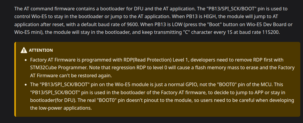

AScha.3
1. Your st-link IS a "clone" . As all these st-link-sticks are . But they work fine , if you have a "good" one, with STMF103x inside . (I have some of these also, so i know.)
2. How you want to program the E5 module with the st-link ? Did you read about your E5 ?
see seed-studio info...
So you should use the AT firmware and only try to flash an update, if you know, what you do!
