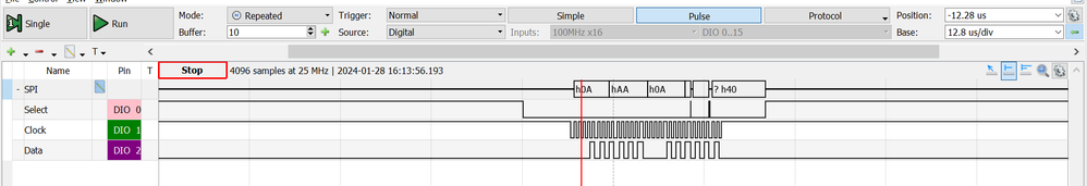

SPI Chip Select Noise with STM32F072RB Nucleo
NumerousObjective7
I'm writing SPI code to communicate between an STM32 Nucleo Board and a TI Dev Board. I'm using a manually toggled chip select pin. The data my TI board is receiving is junk, and after probing the SPI output, It seems I'm getting random noise in the Chip Select. I've tried a lot of hardware debugging, I've changed the boards I'm using (same models but different boards), the wires, nothing seems to make the data readable. I'd appreciate any help or insight! I've included the code I'm running on the STM as well as an example of the noise I'm seeing through my Analog Discovery 2 scope. The two have common ground and 5V.

1 REPLY 1
Are these connected with long jumper wires? Consider reducing SPI speed and lowering GPIO pin frequency. Disconnect external board to see if noise goes away.
Might be informative to see an analog capture to see how bad the other signals are as well.
