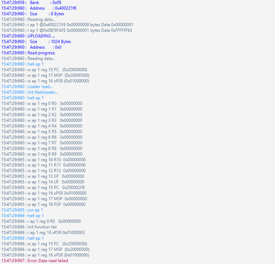

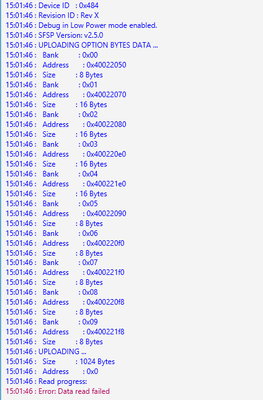

NUCEO-stm32h563zi external loader => data read failed.
I attaching ld file and source file.
let me know how  to solve. please
thanks
KDJEM.1
Hello @togsin ;
Which memory is connected to the SPI?
Could you please check the device, sector and page sizes?

togsin
hello
I add log.
Thanks
Hello~
Is there a size limit on the stldr file?
please reply
Thansk.
