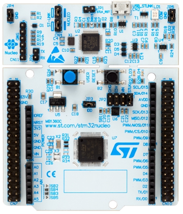

  • NUCLEO-G070RB

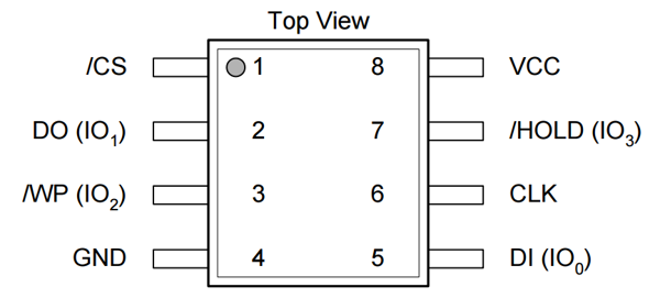

  • External SPI memory (W25Q64)

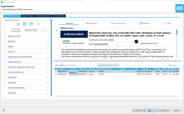

          First, we need to create the External Loader with the drivers to manage our external memory, and setup that to run in RAM. So, let us create a project in STM32CubeIDE for the STM32G070RBT6 (NUCLEO-G070RB’s Microcontroller).

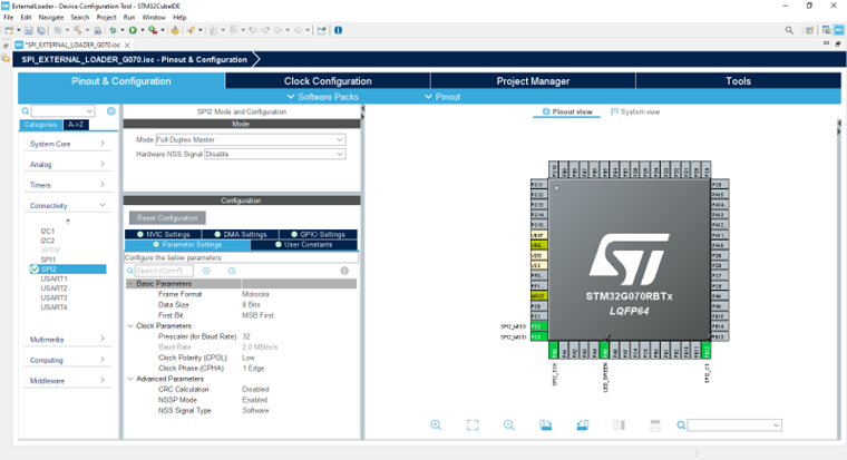

          Configure the SPI according to the memory specifications, in this example a SPI flash memory is used:

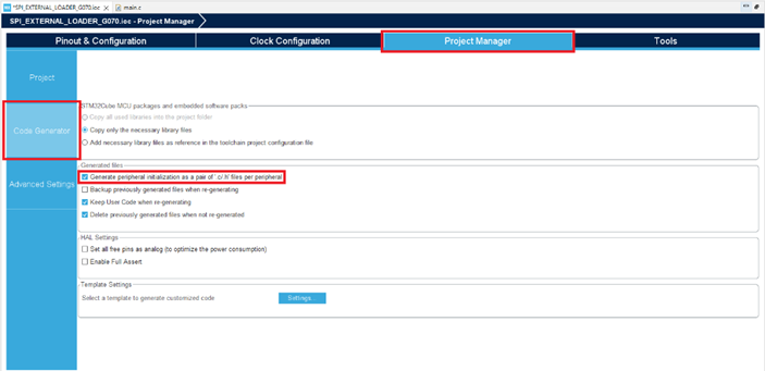

          The main code needs the peripheral initialization functions and later the driver for the memory, also, having the peripherals with individual source and header files make the project cleaner and easier to follow. To do this, go to Project Manager -> Code Generator and check the box “Generate peripheral initialization as a pair of ‘.c/.h’ files per peripheral”.
          Then Generate the code clicking on “Device Configuration Tool Code Generation” or going to Project -> Generate Code.
