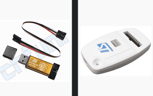

Your board need only
0693W00000Y7MGLQA3.pngand or
0693W00000Y7MG1QAN.pngsome info
