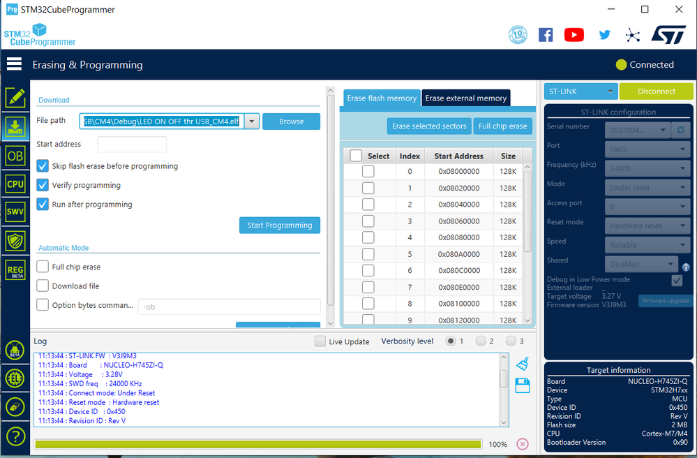

I am working on NUCLEO-H7 board . Its dual core CM7 and CM4. When I Erase the full flash then I click into erase and programming option but I unable to add start address . The core M7 is get programming , but in Core M4 i unable to do programming because in start address block I unable to write . i am using latest version of cubeprogrammer.0693W00000QMvVYQA1.png
8 REPLIES 8
Use a .BIN file, not a .ELF

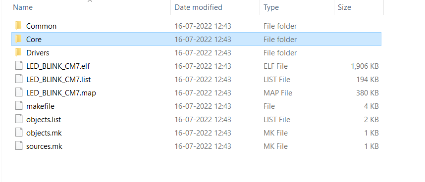

In stm32cubeide there was no option for create .bin
MDeva.1
Mike_ST

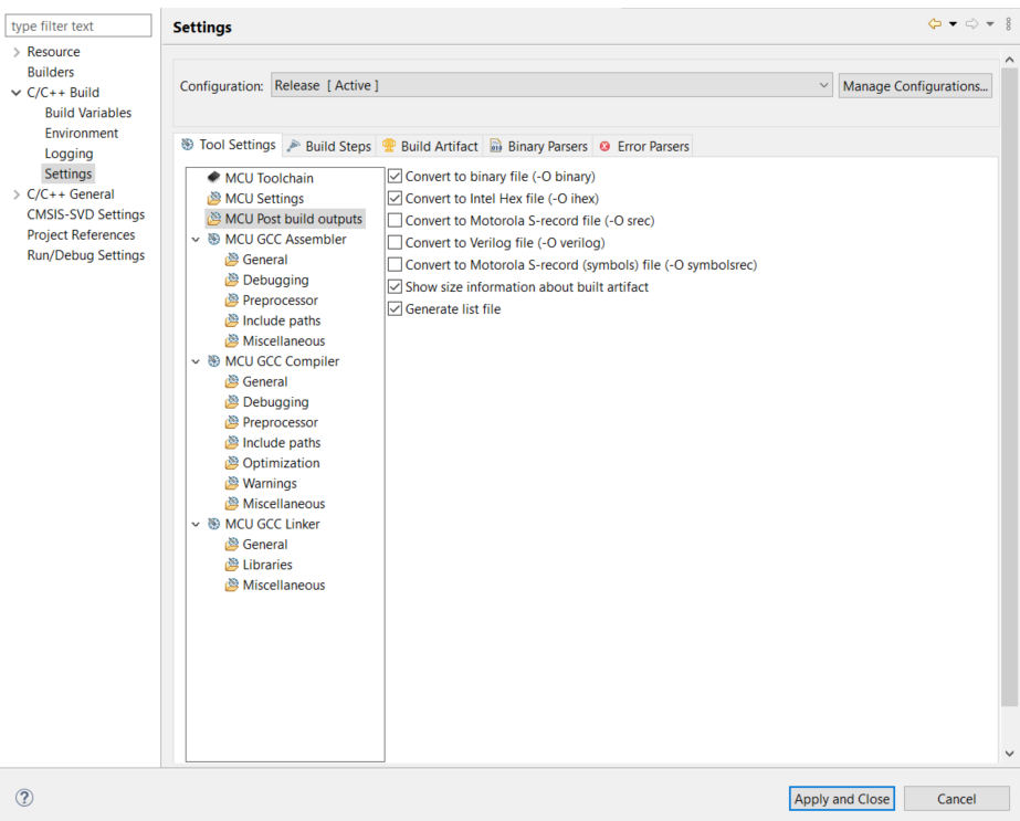

there are options to create bin and hex, please check the following picture:0693W00000QMx3WQAT.pngThey should be created in the same directory as the .elf file.
