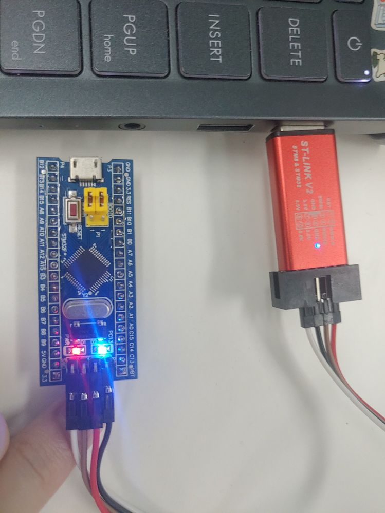

I can't connect to STM32F103C8T6 using STM32CubeProgrammer
chin-su
I tried to connect but it's always: "No STM32 target found! If your product embeds Debug Authentication, please perform a discovery using Debug Authentication"
I also try "Under reset" mode but still not working.
Can someone help me

Are using a USB data cable or charging cable?
Show a schematic
Error suggests chipsnis not powered or connected correctly.
Make sure the ST-LINK gets the VTarget power from the board.
I used USB data cable
I think i connected correct
What is the board are you using? ST board? Custom board?
Check the power supply of the MCU.
ST-Link firmware updated?
ST board i think
I updated ST-Link firmware
I don't know how to check the power supply, sorry
Provide a picture of you setup: your board, the cable connection…
Sorry for late response
Sorry this is neither ST’s board (blue pill most probably with a contrefit chip) nor an ST’s ST-link (copied ST-Link), I cannot help you.
