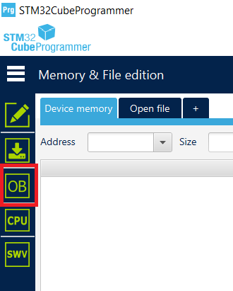

I'm trying to program firmware of more than 1Mb into an STM32L4R5 that has 2Mbyte flash in dual bank. The STM32FlashProgrammer reports a device with 2Mbytes, but during programming only 1Mbyte is reported, and firmware is not transferred.
DBANK bit in OPTR register is set, and I couldn't find any help on documentation and websites.
Thank you for any suggestions!

Dear @paolog​ ,
Dual bank is configurable by option bytes. Option bytes settings are available in STM32CubeProgrammer. Click on "OB" button as indicated in the following photo and you will access to all option bytes settings.
Thank you for the prompt reply, @Community member​
As I wrote, the DBANK bit in OPTR register is set but still the programmer reports 1Mbyte of flash to program (while under the ST-Link windows reports 2MBytes). Is there any other flag I should check?
