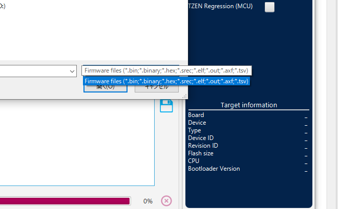

I'm currently investigating to implement the update feature.
This time I will not use the built-in boot loader.
So I can't even use STCubeProgrammer.
The CubeProgrammer User's Manual states that the following file formats are supported:
[ bin, binary, hex, srec, elf, out,axf ]
Also, I was able to confirm the same with Cube Programmer.
I checked the H723 reference manual, user guide, and datasheet, but couldn't find a supported file format.
Does this mean that the file formats supported by the H723 are the same as those supported by the Cube Programmer?
Please let me know if there is an explanation somewhere in the bibliography.
Or, if the reference materials etc. describe the detailed operation when creating a hex file with Cube Programmer, please let us know.
I would like to know how CubeProgrammer specifically updates the firmware.
( Isn't the hex file sent directly to H723? ?? I don't understand )

Dear @june ,
Tools usage is not part of Reference Manual of products.
For STM32CubeProgrammer documentation, you can refer to its user manual UM2237.
Normally, these file formats are supported by all STM32 devices.

2022-02-10 4:18 AM
The part itself doesn't understand formats, the external tools digest the formats and push small packets of binary data.
Your own code on the STM32 could ingest what ever formats you are willing to code support for. Binary or simple packaged binaries (ie DFU or minimalist object)
Coding for Intel or Motorola hex isn't unduly complex, but the data tends to be 2.5x larger than binary.
People frequently used X/Y-Modem to push binary/packaged data as the PC side terminal software already supporting those protocols is readily available.
