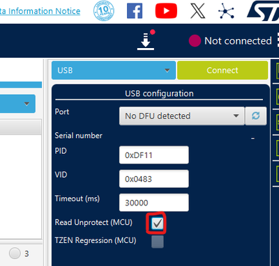

I assume RDP means Remote Desktop Protocol. Is there any means for disabling it programmatically with C#? How would it get enabled? I'm pretty sure I'm not enabling it with my program
I tried "–ob rdp=0x0" but got a -1 result, meaning Not Connected. So I'm in a situation where I can't connect because I'm getting -16 (RDP enabled) and I can't disable RDP because I'm not connected
MSSloan1962
I've now found that RDP stands for Readout Protection
Hello @MSSloan1962,
You can disable RDP 1 by a debug connection (ST-Link or JLink) or by the read unprotect command via bootloader interfaces :
Could you detail the case where RDP was set to 1 ? Can you reproduce it with your API project, if yes please share your code and detailed steps to reproduce.
