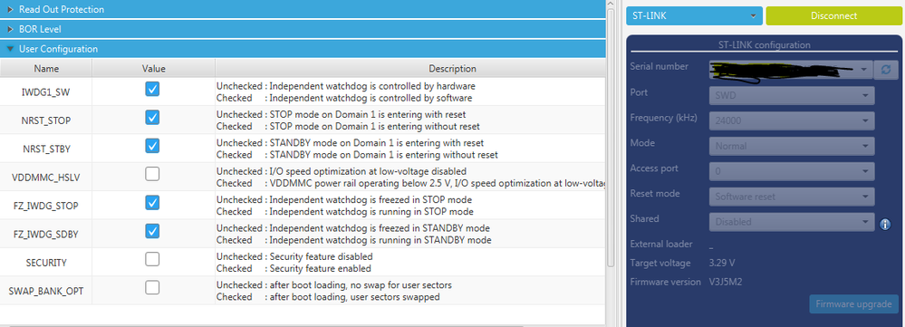

I am running the Secure Boot Secure Firmware Update (SBSFU) example program. Below is an image of my "Option Bytes" I can't see any of the flag to cause this behavior.

Probably SBSFU sets RDP to level 1, which makes memory unreadable with debugger.

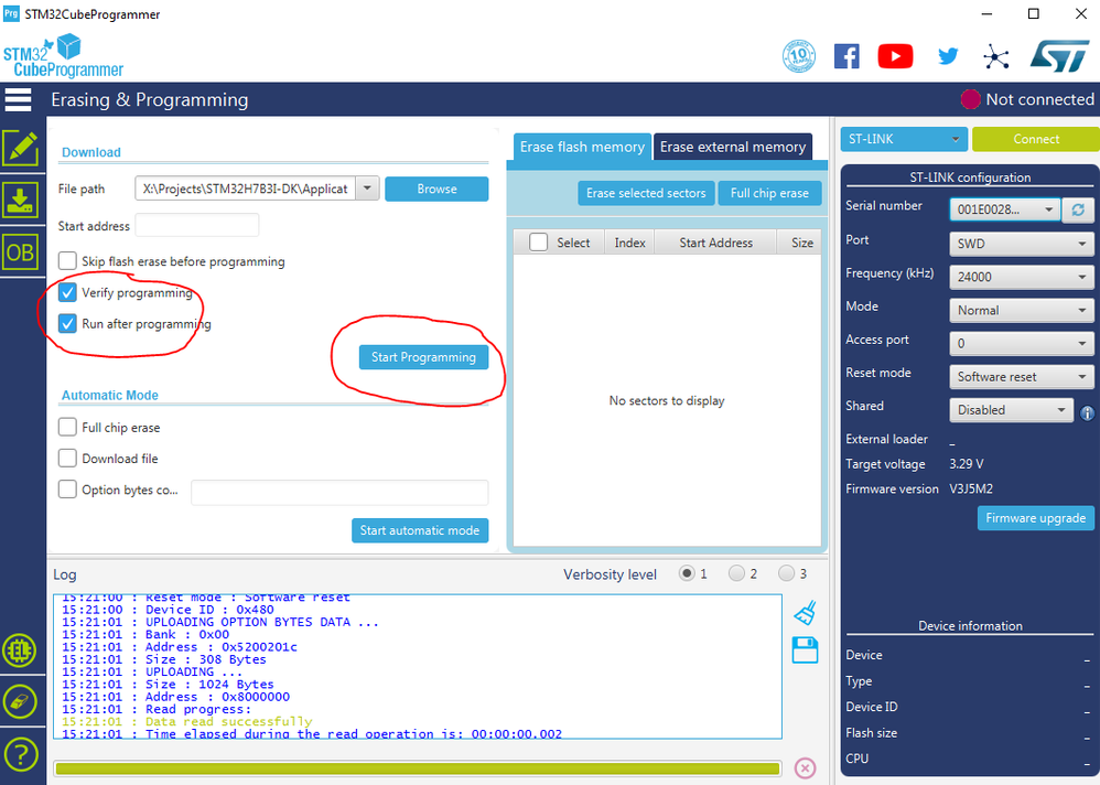

When I flash the device with STM32CubeProgrammer see image below the application starts to run immediately as set and shown in the image highlighted in red.
However when I power cycle then it stops and when I connect to see contents they all show up as 0xFF which means blank.
‎2020-08-22 8:07 AM
The RDP level applies to whole MCU memory, not some sectors or ranges. Apparently the software shows 0xFF for unreadable memory. Your firmware is there, you just cannot read it with external tools - that's the whole purpose of RDP (ReaDout Protection). :)
Not starting is another issue. The "Run after programming" feature probably starts your code directly bypassing the bootloader, but after that normal reset starts bootloader. With SBSFU there are signature involved - that must be valid.
Also, after setting RDP (even if SBSFU does it), the MCU requires not only reset but a power cycle.
