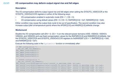

You need to check the XSPI2 configuration. May be this STM32CubeN6/Projects/NUCLEO-N657X0-Q/Examples/XSPI/XSPI_NOR_MemoryMapped_DTR at main · STMicroelectronics/STM32CubeN6 · GitHub example help you for verification.
Please try to disable the I/O compensation cell (EN = 0, CS = 1) on the relevant power domains (VDD, VDDIO2, VDDIO3,VDDIO4, and VDDIO5) and use fixed compensation values for the RAPSRC[3:0] and RANSRC[3:0] bitfields as mentioned in the errata sheet.
