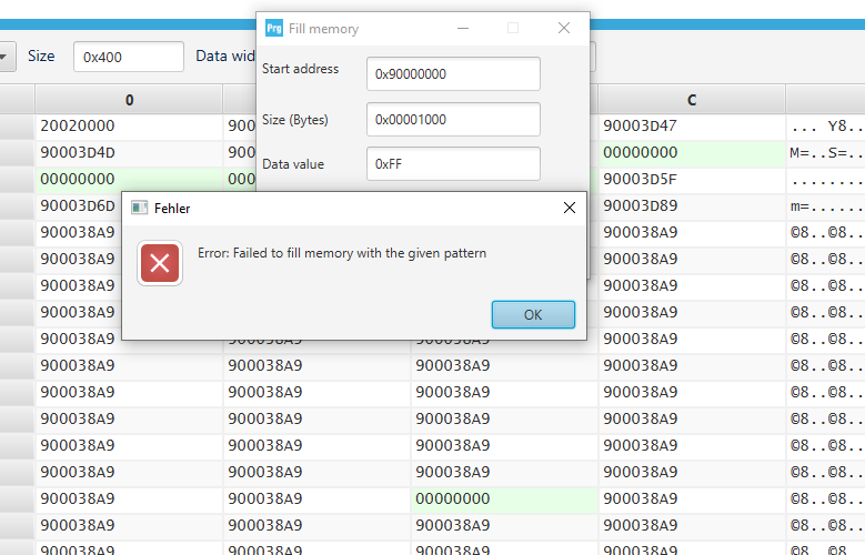

I always get a Data mismatch error... what can I do?
I already tried to erase external QSPI flash, but without success :-(...

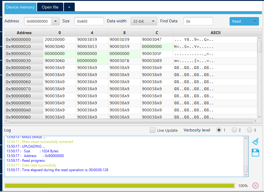

How to erase external Flash? It does not work with Cube-Programmer, or it does not look empty...
see:
You'd need to click READ button again, perhaps with less length to reduce time, as this won't auto-refresh.​
A​ mismatch suggests the write or prior erase failed. At a bit level perhaps bus integrity or timing.

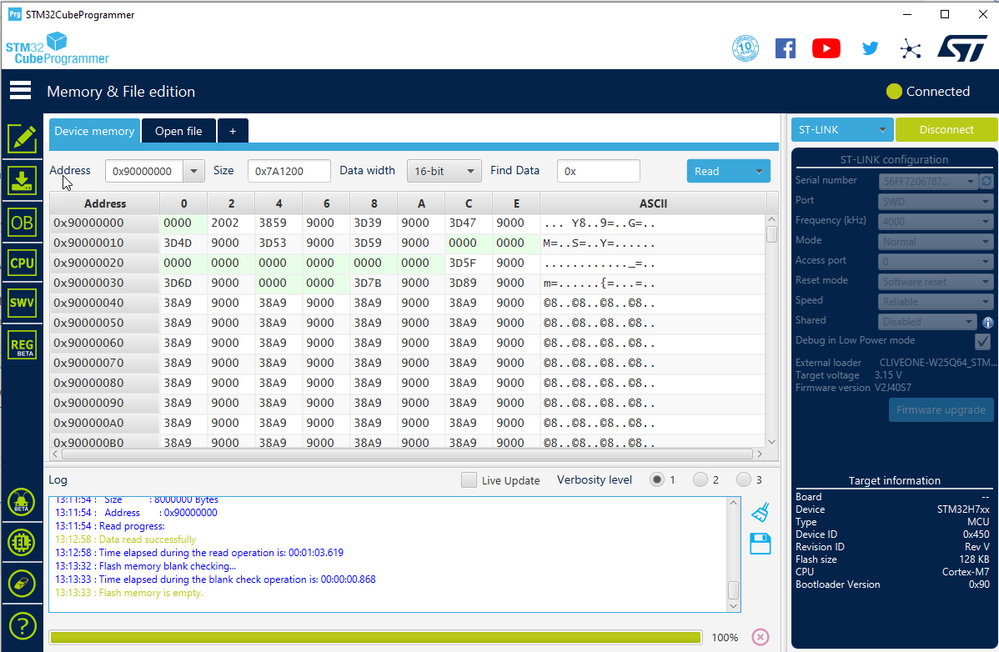

I get the message that erase was successful, but it does not look empty, why this, see image below?

If you re-read the data after the Erase, then it's looking like the erase is failing or ending early.

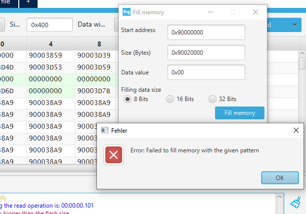

I click full chip erase at external flash and I don't get any error message, but memory still looks not empty. I also cannot fill anything...
Those seem contemporaneous with the last time I worked on them.
I will need to fixture some devices and check what's going on.
Are you sure you're erasing the external part? The UI is a bit clumsy.
Also get some logging data, with the Verbose Level set to 3, the mass erase can take several minutes on some devices depending on the size.
