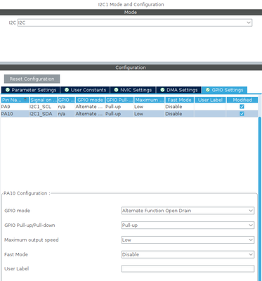

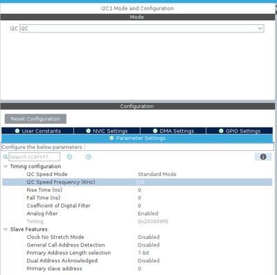

‎2024-07-14 10:38 PM - edited ‎2024-07-14 10:40 PM
Set pullups in Cube ...see:
for all used I2C pins ; no pullups = no I2C game.
set speed to something low, 10 kHz or so;
‎2024-07-14 10:50 PM
my bad!!!!
i thought when i click on the gpio pins their setting would pop up,
but i have to scroll!!!
thanks a lot.

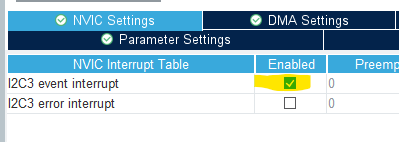

‎2024-07-15 7:14 PM - edited ‎2024-07-15 7:19 PM
Edit: I've just noticed @AScha.3 mentioned the same thing that I just wrote below, lol.
You've commented out HAL_I2C_Slave_Receive_IT(&hi2c2, RxData, 6); but you need it.
You don't need the delay in the callback.
Make sure you enable the NVIC interrupt.
