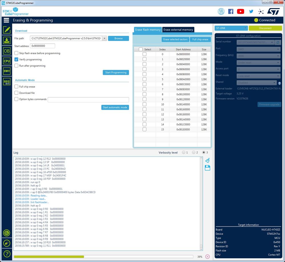

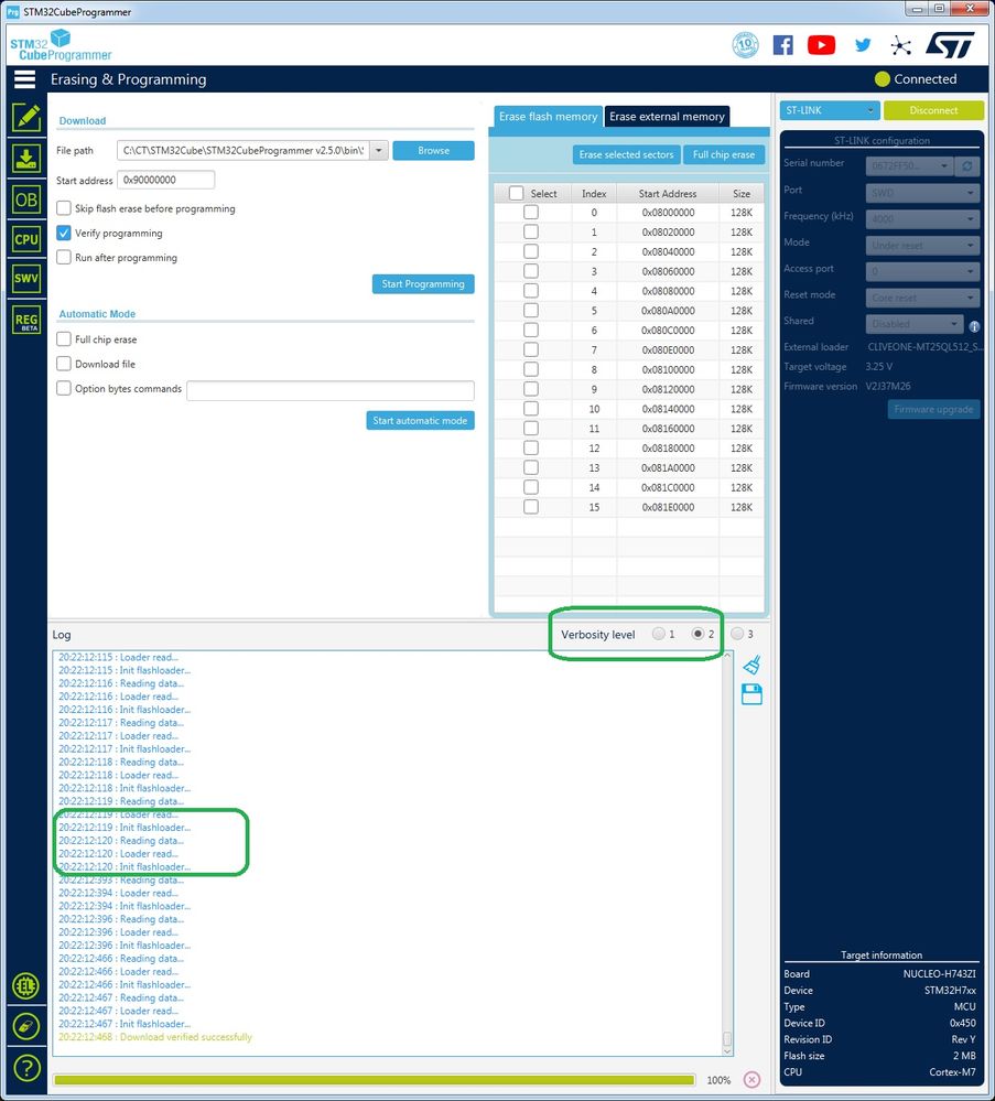

Here trying to understand interactions with an External Loader in STM32 Cube Programmer.
I'm fine with one line of information, but put some actual information in that line, ie for a Read the Address and Size would be a MINIMUM.
I'd use Level 3, but the method used for the Logging Window CHOKES when doing a million SMALL reads on a 32MB SPI device when verifying. What controls the size, the H7 has loads of RAM it uses on Writes?

Here grinding along in Level 3, trying to verify an 8MB image 1KB at a time, getting exponentially slower, like the logging method uses a bubble-sort or some continuous malloc/copy to a bigger and bigger buffer to add lines. Window is entirely unresponsive to user interaction, ie scroll, move.
