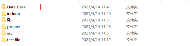

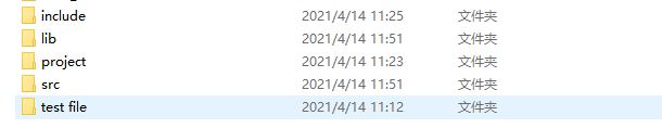

0693W000008zTbFQAU.pngWhen I succeed, I must share this good news; I use USB_Example as an example;
At first I thought the typesetting was wrong, so I used the same as ST0693W000008zTb5QAE.pngBut he still can't
Until I added this folder, it succeeded!
Sorry, the first picture is at the end

If I understood correctly, you just added the folder `Data_Base` to your project?
Must be added in the upper directory of the directory where the .exe is located

Thanks, I made a python module for CubeProgrammer API, and
setLoadersPath + copy of the "Data_Base" fixed my problem.
