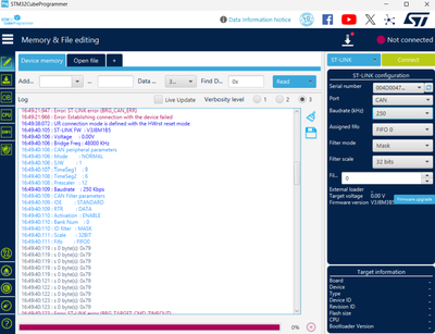

Ive been trying to use the FDCAN systembootloader from a stm32H757XI, in the past i managed to use the CAN systembootloader from a stm32f405RE succcesfully.
But im getting> nothing , i tried with 125 and 250Kbauds, CAN connceted to PH14 and PH13
Is FDCAN systembootloader compatible with STLINKV3+CubeProgrammer?

@Javier1 wrote:
Is FDCAN system bootloader compatible with STLINKV3+CubeProgrammer?
Apparently not - see your other thread:
https://community.st.com/t5/stm32cubeprogrammer-mcus/cubeprogrammer-stlinkv3-supporting-fdcan-system-bootloader/m-p/764162/highlight/true#M7726
(a limitation of the ST-Link V3 rather than the bootloader itself)
