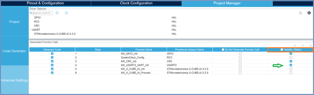

Hello @piernov​
Thanks for your feedback,
In fact, you can change the Functions Visibility directly through CubeMX and according to your need, you can find this option under Project Manager- Advanced Settings as mentioned in the image below:
Hope my answer helped you, when your question is answered please close this topic by choosing Select as Best, this will help other users find that answer faster.
Thanks for your contribution, Khouloud

‎2021-03-08 5:59 AM
Hi again @piernov​
Actually, when the function is generated as static, it will be initialized only in main.c, in case when it's generated as non-static, it will be defined also under main.h, so that the problem will not appear.
Could you please check with the latest CubeMX/IDE versions (6.2.0 and 1.6.0)?
Thanks, Khouloud
