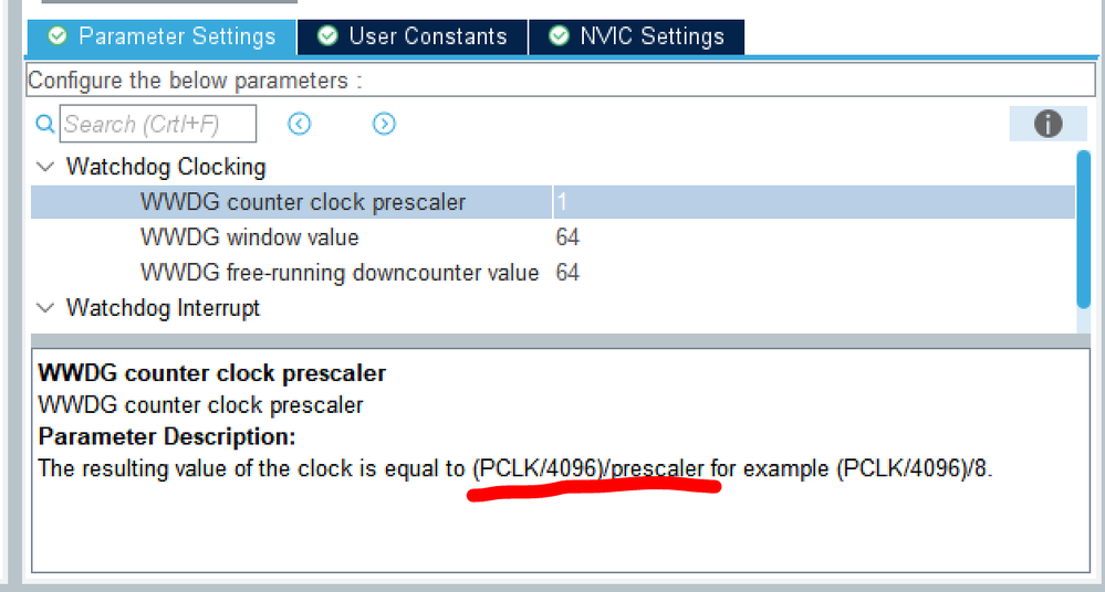

From L475 datasheet and reference manual it was mentioned that the WWDG clock source is from PCLK1. Whether PCLK1 Timer or Peripheral clock is used for WWDG? I couldn't find the details..
Attached reference image from cubeMX
Thanks

WWDG is in APB1 and is clocked from PCLK1.

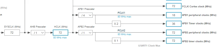

If it is PCLK1, then with below configuration of counter and window value I am trying to reload the counter every 2.5ms but the uC reset is happening because of the counter value is greater than window value. What could be the reason?
But if I configure the window and counter value(considering 36MHz) as (WWDG_CR_T_6 | 0x14) and (WWDG_CR_T_6 | 0x1D) respectively then it is working fine.
HCLK is 72 MHz
APB1 Prescaler is 4
PCLK1 is 18MHz
